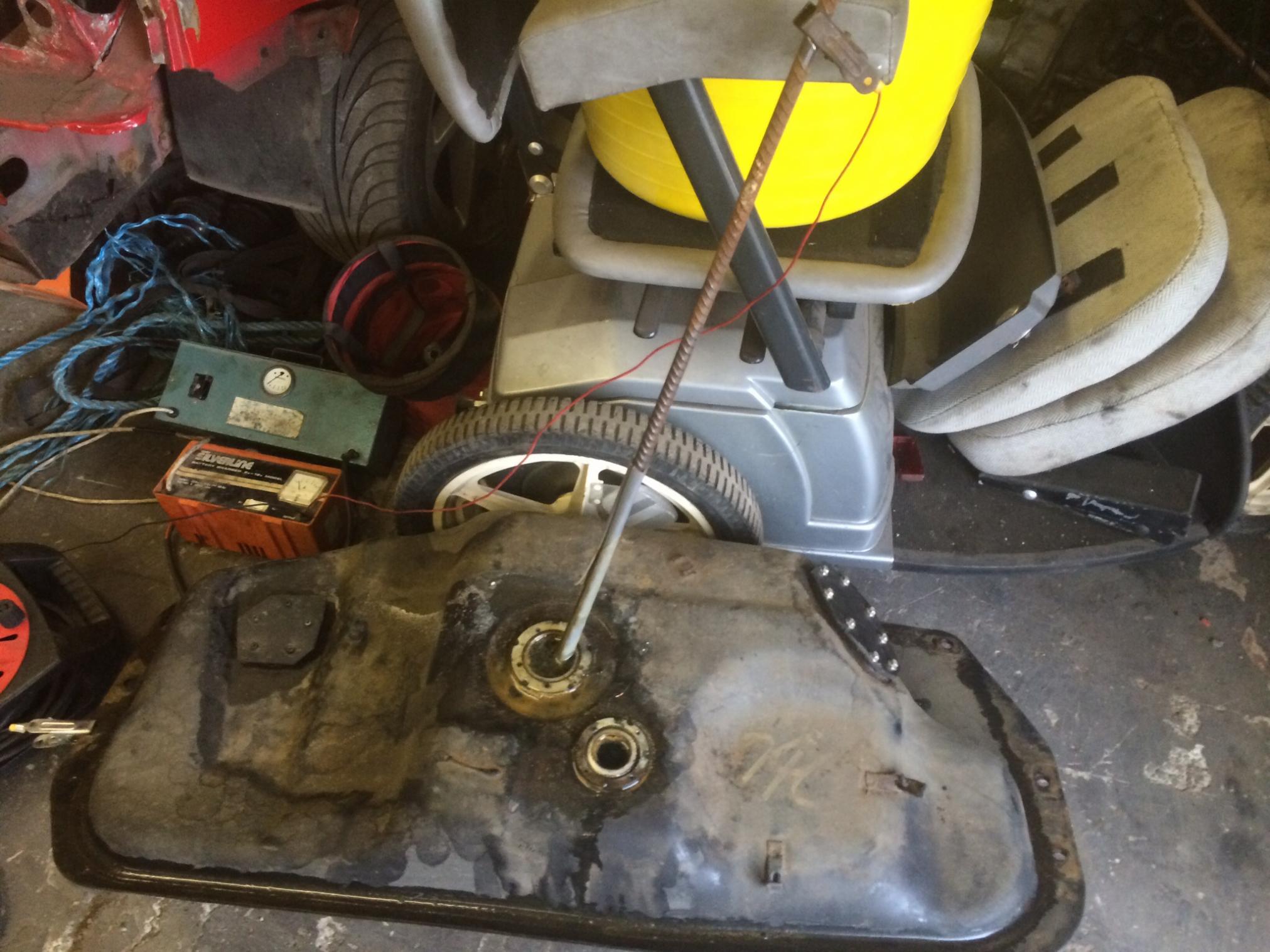

                    So I had decided to use electrolysis to hopefully clean the tank.

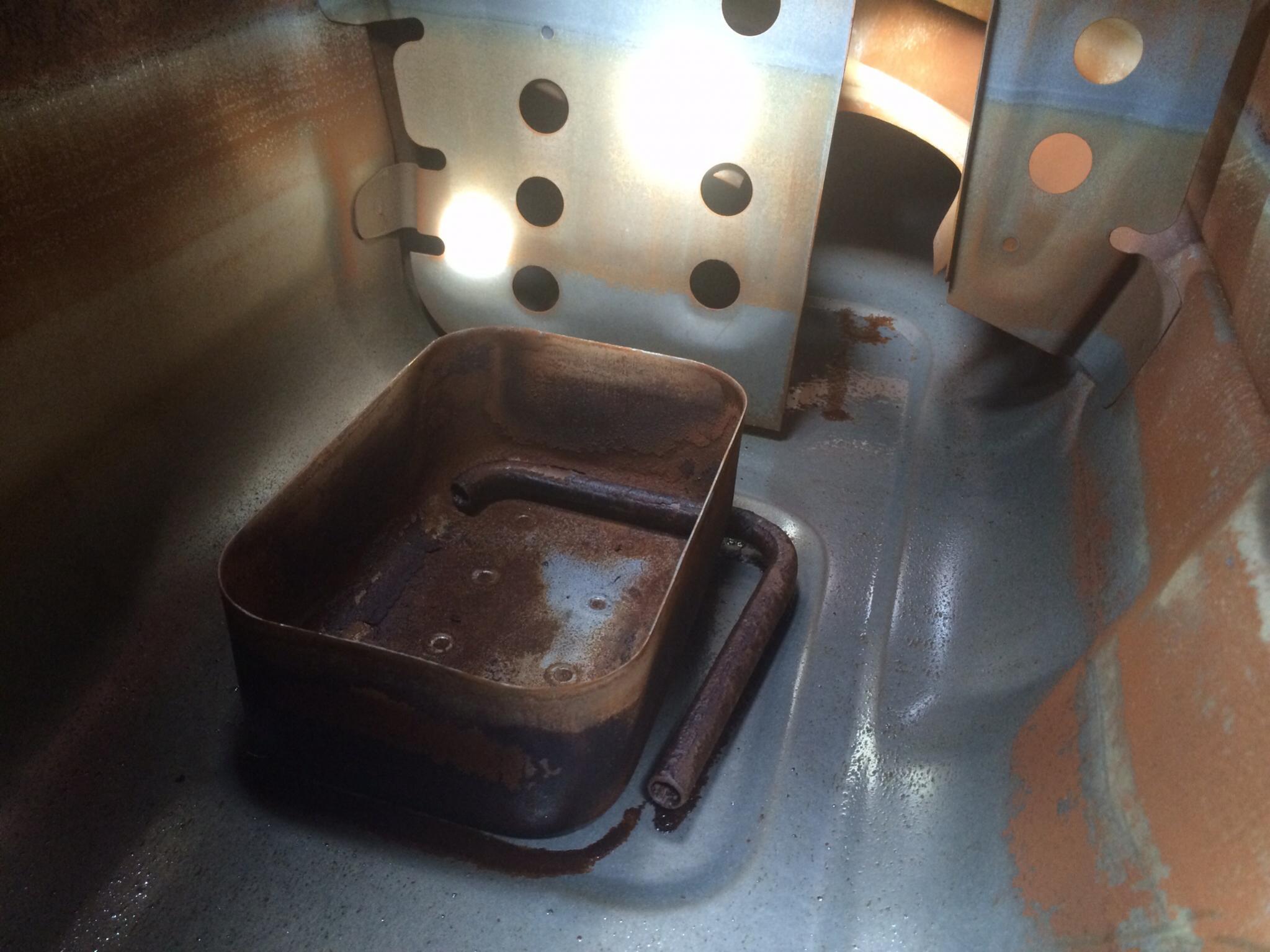

                    Couple of photos below of before and after the first 24 hrs.
                    Got round to doing the exhausts, I will post a video of her running as soon as I work out photo bucket :-)
                    BEFORE
                    ALL THE GEAR!............no idea!
                    • The set up
                      • After 24 hrs. I have now added a battery in between the charger and the tank to stabilise the current fluctuation

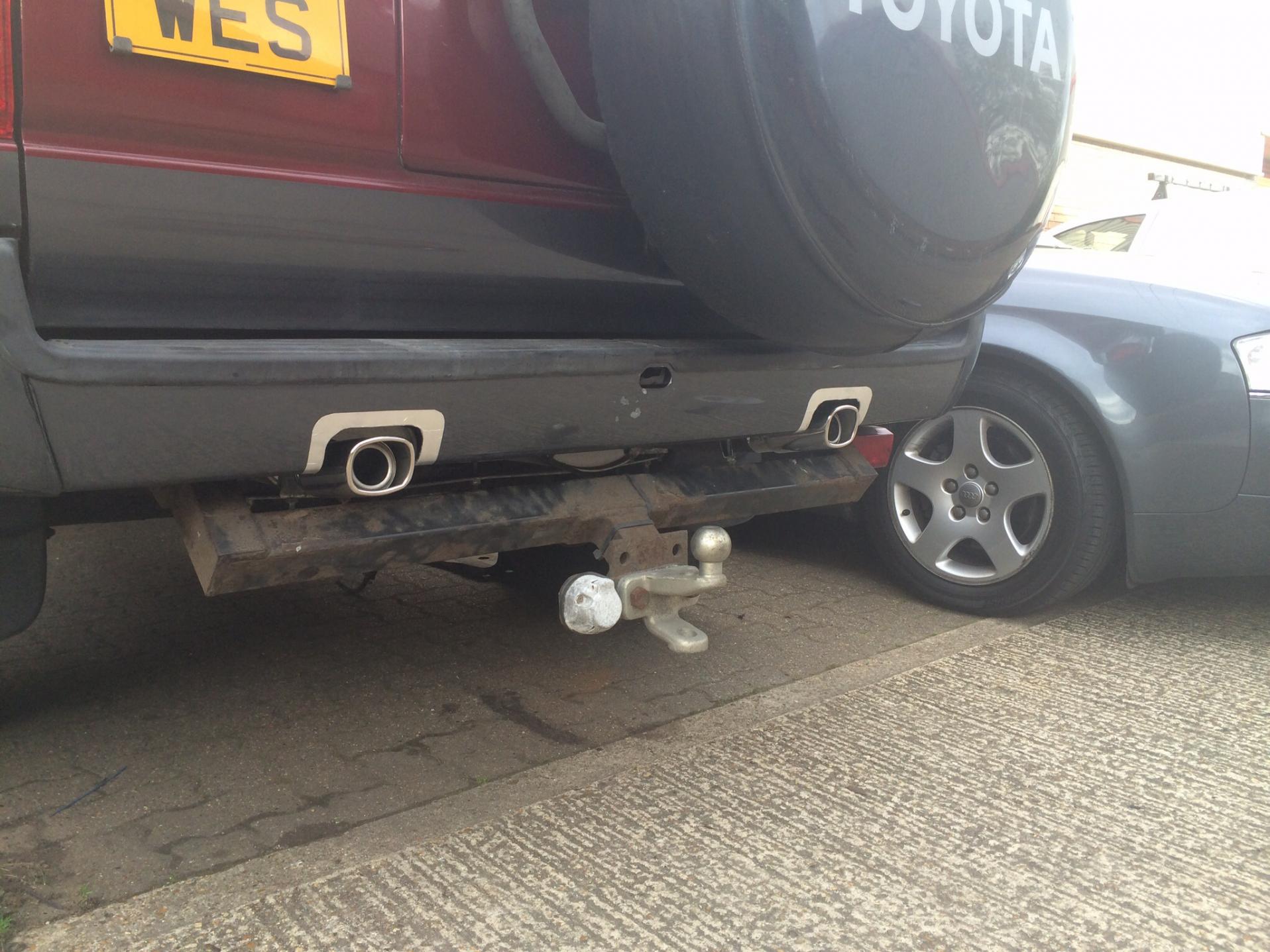

                        • Zorsts
                          • After 48 hrs
                            Think I may need a bigger charger

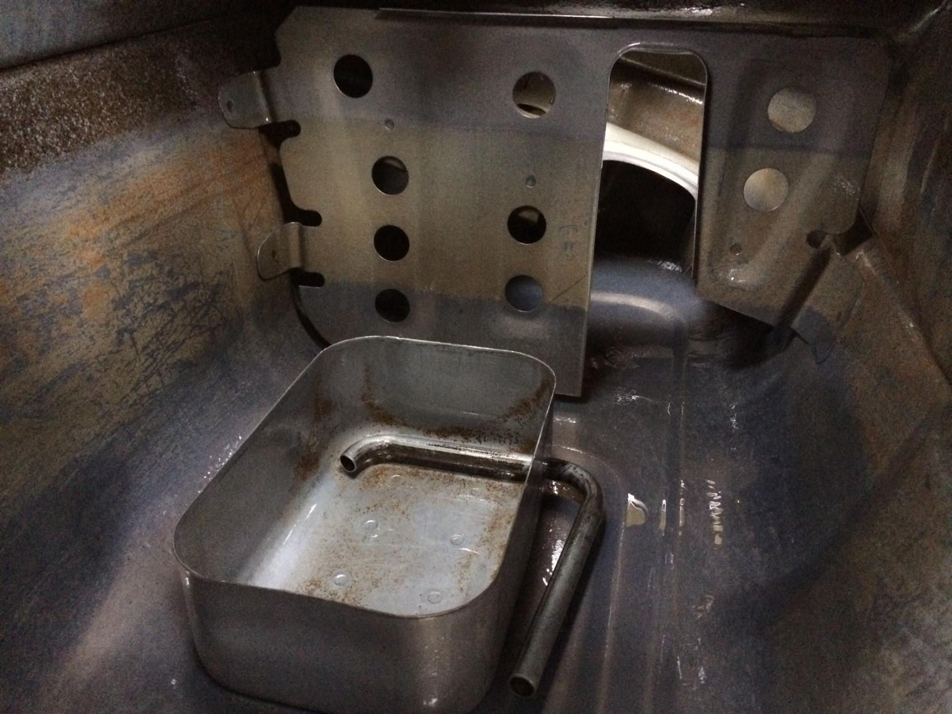

                            • Ok so here is the tank after the last 12 hours of electrolysis and after I washed it out with bilt & hamner detox c and a few bolts to remove the rust.
                              I think the electrolysis loosened a lot of the rust and the detox c and the bolts washed most if it off.
                              Also a few pics of the new zorsts :-)

                              • Tank
