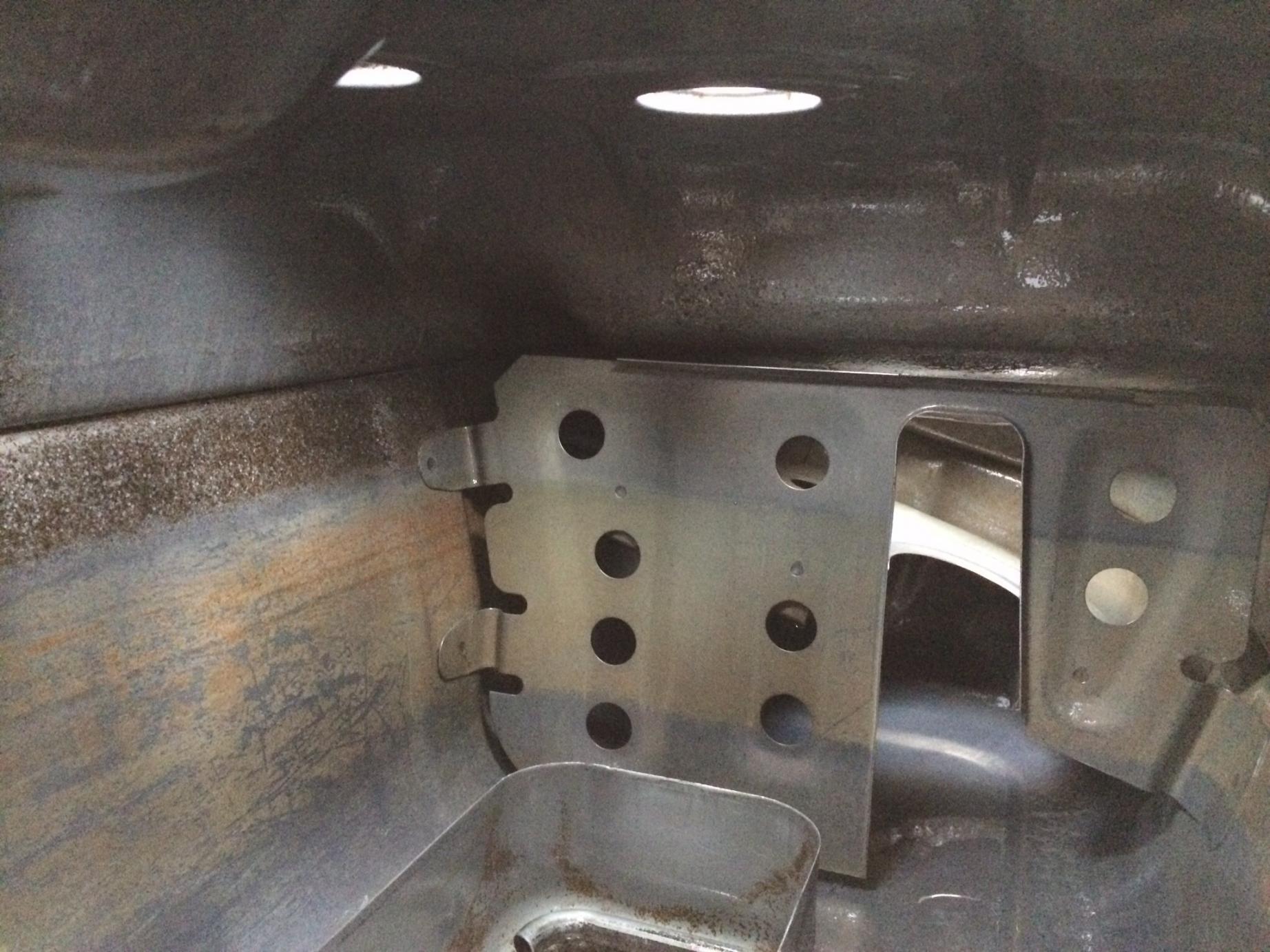

  • Another of the tank
    ALL THE GEAR!............no idea!
    • Zorsts
      • That tank has cleaned up nicely!
