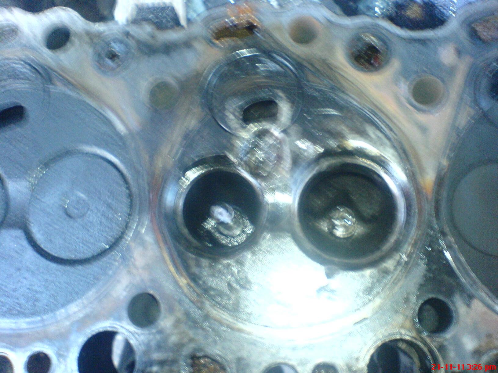

                    hi tony took head off and can confirm there is no piston in no.2 cylinder only top off shattered conrod inlet and exhuast valves disapeard also first time when fired and herd big bang thats what it must have been inside cylinder scored . so am on the look out for another engine? if you know anybody got spare want thank all you guys for helping alonge this thread all the best

                          hi tony where you located? i think i might have to get cylinder head also as you can see in pic. took bit of impact. how much do you want for the block tony?
