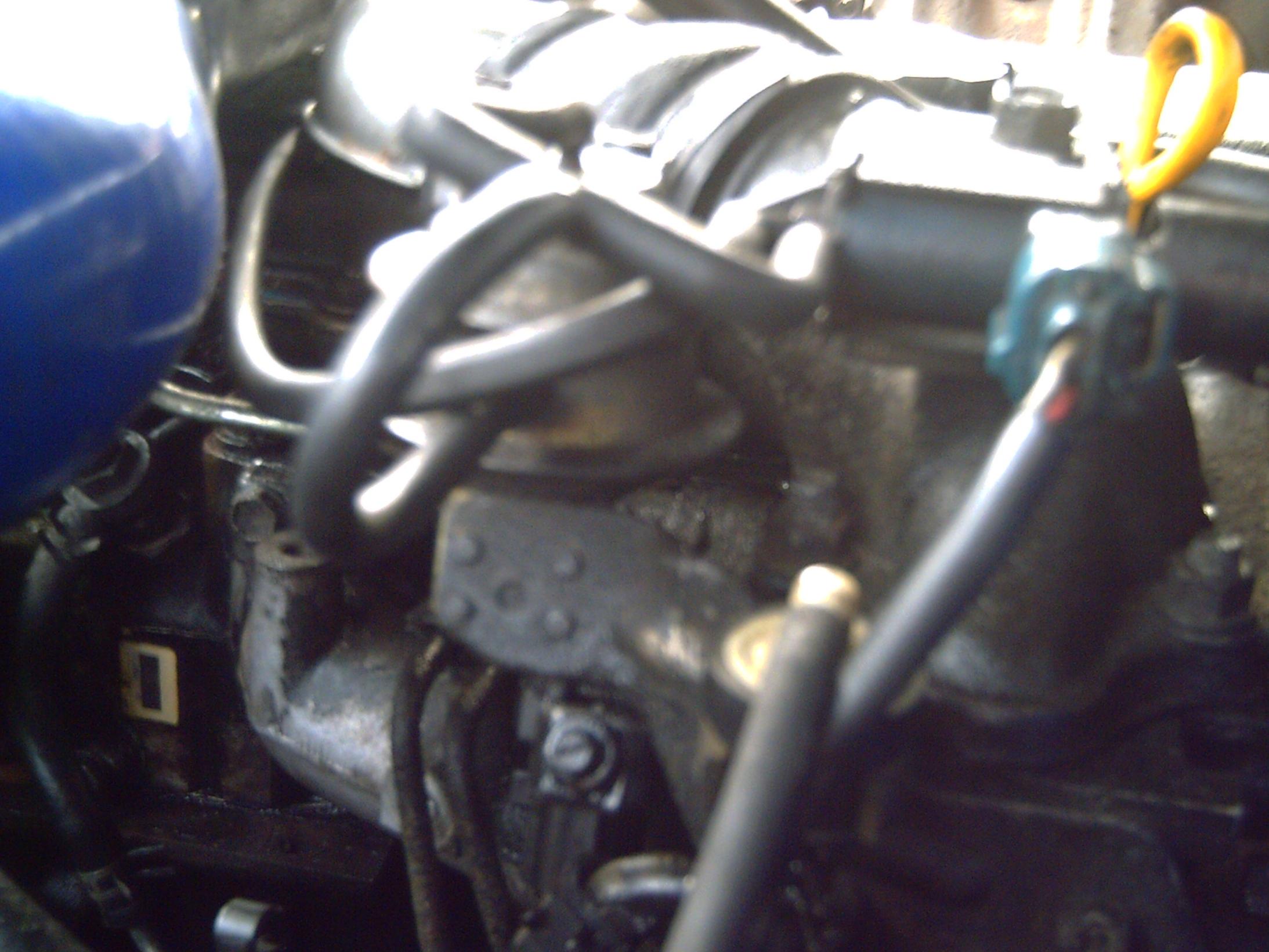

                        • OK, so it was running when you took turbo off, swapped turbo now it doesn't run.
                          There isn't a lot to get wrong just doing turbo, blanking the EGR could have messed up the throttle butterflys if the vacuum hoses are wrong. Can you post a pic off the hoses around the intake manifold.
                          It can't have just lost compression just like that, especially if it didn't even run on easy start, could someone have dropped something down the intake while working on it?
                          Maybe there was nothing seriously wrong with the turbo, the lack of compression could have been why it felt like the turbo wasn't 'working' originally.
                          If you're sure the compression test was done properly you'll probably have to take the head now for a look now anyway, oil down the bore will only prove the rings are worn, it could still have holed a piston or have a bent valve.

                            green turbo light always came on when the turbo kicked in always lagging on uphill climb . anyways i dident drope anything down intake mani. while working on it. and car drove not ben started since change over so can't bent valve good news then regards to compression test dident have compression tester just rolled up cloth stuck in turned over and shot out no.2 nothing .if i havent bent valve what about if i just set timing wip came off check under pot?

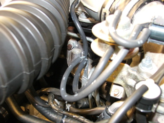

                              • My Set Up
                                Hi Frank,
                                My pipe set up appears quite different from yours. I have had it like this for about 3 years now with no drama's at all. Who knows, mine might be wrong as well but it works!! Perhaps one of the more knowledgeable on this forum might concur. Good Luck. Sorry about the poor quality image.
