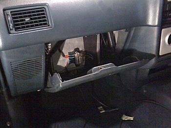

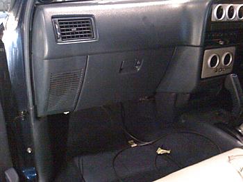

                          • ecu hidden
                            after 10 hours of soldering the ecu is now in the glovebox cuddling the relays and fusebox. i now have a glovebox that holds 2 postage stamps and half a pencil but its a bit neater.
                            it gives easy access to the fusebox, relays and the ecu.
                            i thought about moving it under the seat but it would be a real pain having to take a seat every time i want to fiddle with the ecu.
                            • Originally posted by gary-r View Post
                              Very neat.
                              There's guy on Lextreme that has extended all 80 odd wires of his loom just so he can fit the ECU behind the seats in his pick-up. Took him six hours apparently.
                              I'm going to look at creating a glovebox or cubby hole in the top part of the dash if possible.
                              Changed my mind about trying to get the Lexus dash to fit, it's never going to look neat however I do it.
