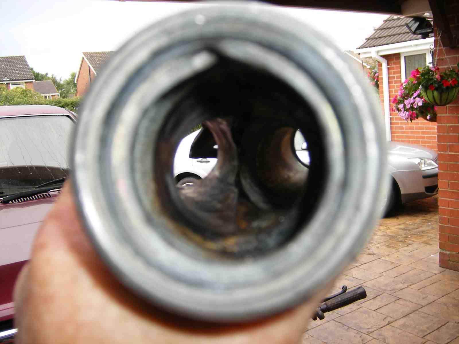

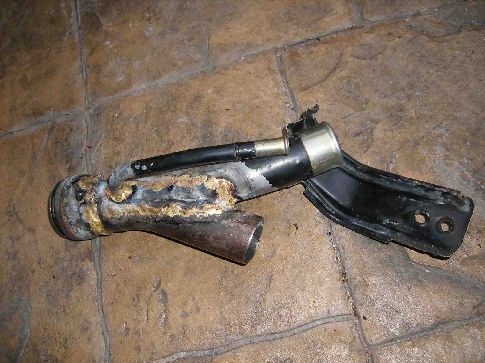

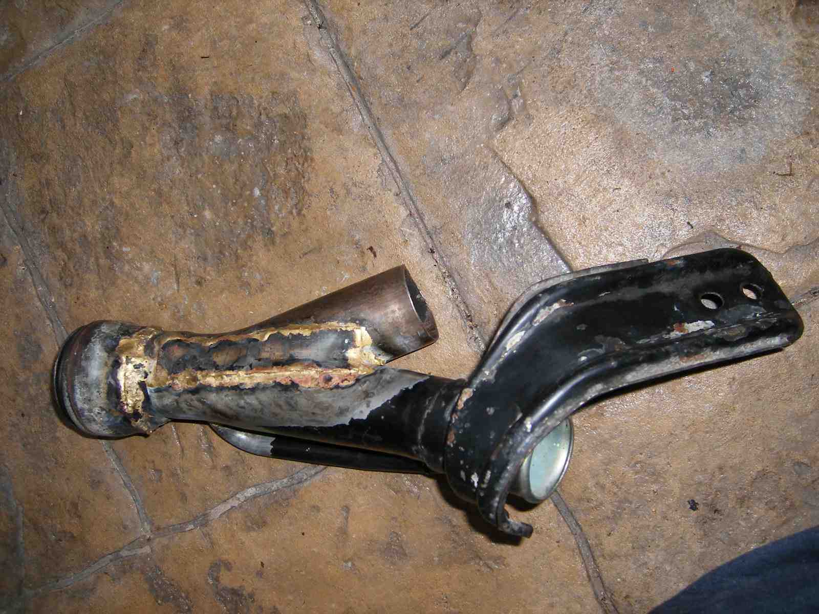

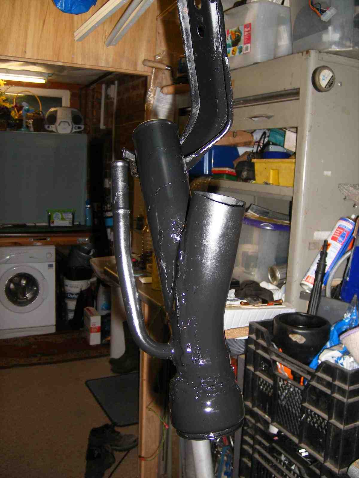

Decided to start again, not happy with the outcome so I am going to cut the top bit (where the cap screws) off then saw down at an angle, weld a filler from the scrap yard then reweld the filler bit on.
May have to get some more oxygen, used a lot yesterday. Stainless brazes with brass braze OK if you do it quick, if it blackens, forget it.
Going to do it in mild steel.
Will post pics when done.
I am going to see the service manager of the local vauxhall dealership who I have known for about 20years and see if any of their bolts will do the biz, if not then the scrap yard till I find one that will.
