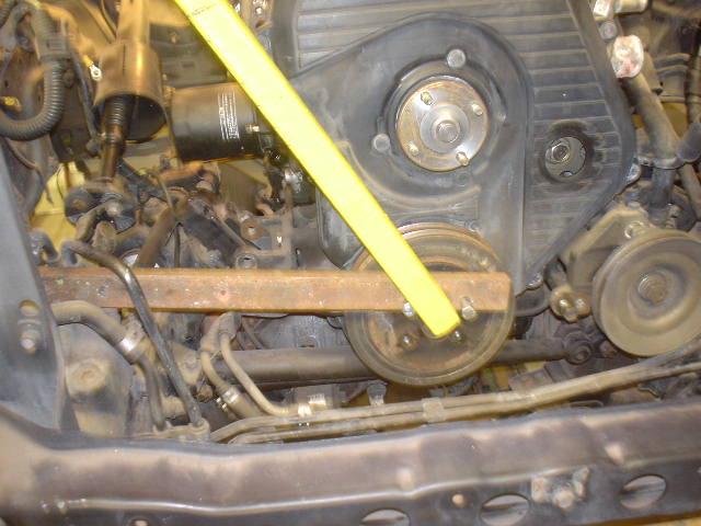

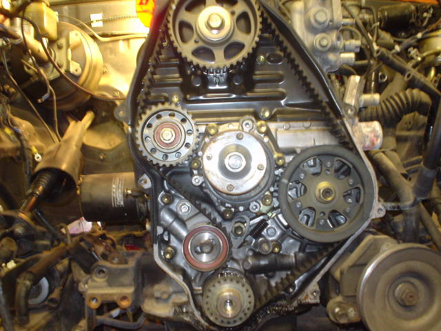

                          to get the crank bolt out you'll need to "lock" the engine from turning, it's best "safest" to make up a bar drilled to enable you to bolt it to the crank pully once the two forward pullys have beed removed, undo the four small bolts you can see in the front of the pully and these two will come off with a light tap, then bolt the bar to two of these holes, bolt it so you can still get a socket/ring spanner on the main bolt, you'll will prob need a decent size wrecking bar to shift it tho, mine was sodding tighter than a spaniards arse,

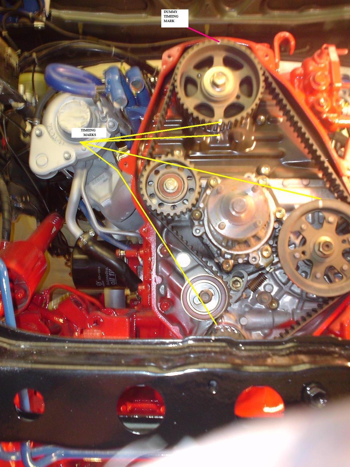

                          it undoes usual way (anticlockwise), then tap off the main pully, dont forget to line up the timeing marks after removeing the cover before you start undoing timeing belt, pump, head etc

                            Thanks for the pics, it looks frightening inside that cambelt cowl, do I have to remove the complete cowl including all the other pulleys.
                            I hadnt realised the bottom pulleys were bolted on separately I thought the big nut held the lot.

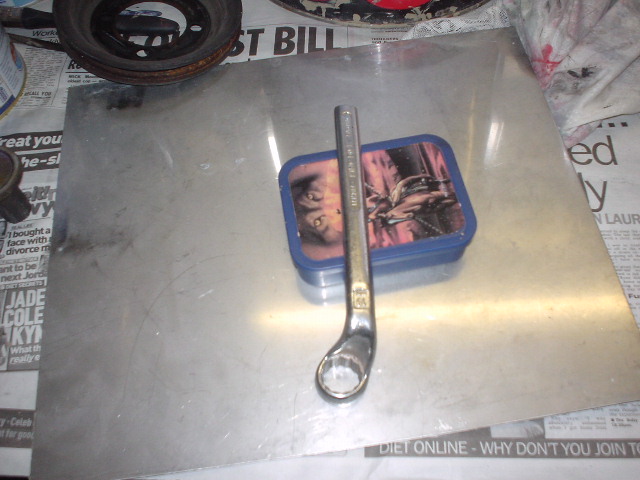

                              The main crank bolt does hold the lot on and if the bolt aint too tight you'll get away with a socket and short extension, however if it's tight this will only slip, you cant get the leverage and hold the extension from twisting at the same time, i split a socket on mine, in the end i cut a ring spanner down and slipped a lenght of box section over the end, removeing the front two pullys(which bolt to the harmonic ballencer pully) just enables you to to get a better purchase on the bolt and somewhere to bolt the locking bar,
                              never had the head off so hopefully someone who has will offer advice, but going on past motors i've had it's "doable" take plenty of pic for refferance and lable up the nuts, bolts and bits as you remove em, and ya wont go far wrong, just make sure you use a toyota head gasket and not a milners cheapo, new bolts (and measure em against the olduns, and clean out the bolt holes in the block), a decent torque wrench, good luck

                                Made a locking bar up as you recommended, then pulled off the big pulley and the injector pump pulley.
