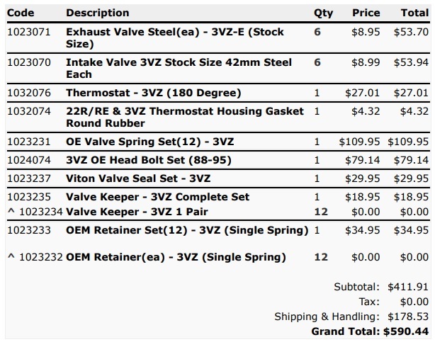

                              Yeah, it was a Sinking Feeling moment..
                              But, all is not lost, It's just a case of How Much to fix it.. So, I have ordered a rather Long List from LCE Performance in the US, with some other bits still to find..
                              I have booked in some Ramp Time at a mate's Garage, and with [quite a lot of] his help, I'm going to do this Top End Rebuild myself.
