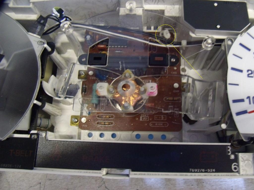

Is it possible to get the rev counter working properly?
It won't get it perfectly acurate, but turn the potentiometer on the PCB behind the tach faceplate, fully clockwise.(see photo attached)
