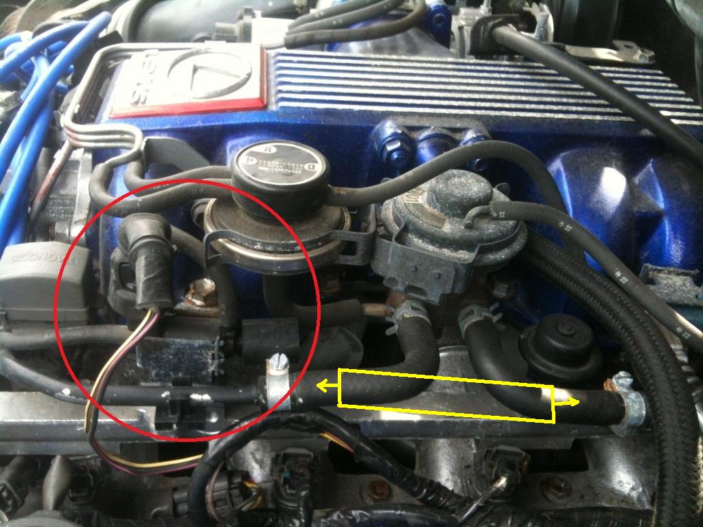

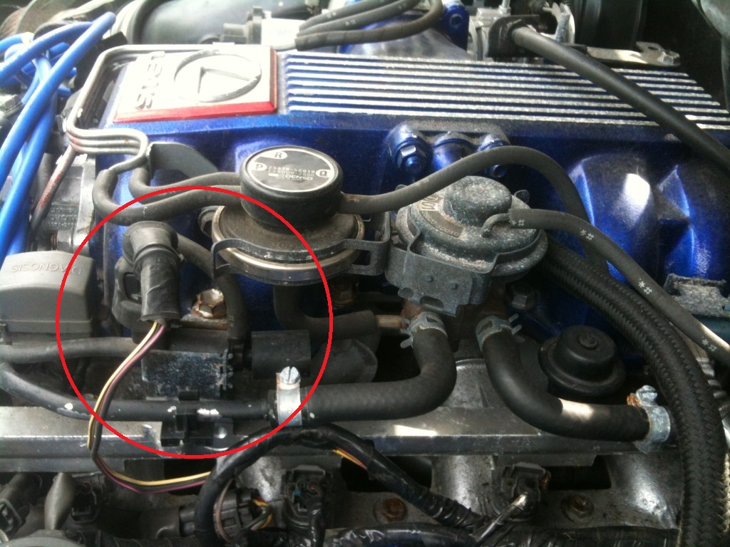

                        Vince - Is it OK to remove the VSV Circled in this picture? It has something to do with a valve on the O/S fuel rail.
                        • #87
                          Leave that connected, it controls the fuel pressure regulator on the O/S fuel rail.
                          You can run a vac hose from the top of that VSV (centre of your red circle) direct to the F/P regulator and bypass those thin metal tubes that run around the front of the inlet plenum.
                          The bottom vac hose on that VSV goes to the front of the plenum.
                          You can junk everything else on the N/S of the plenum in your photo and plug any open ports on the throttle body. Join the two coolant hoses together though as they connect the front and rear water bridges. (see photo below)
                          • #88
                            I've disconnected everything else and fixed the hose. I was playing around with that VSV and it seemed to be active at startup (until I disconnected that STA wire for testing), that's why I left it connected.
