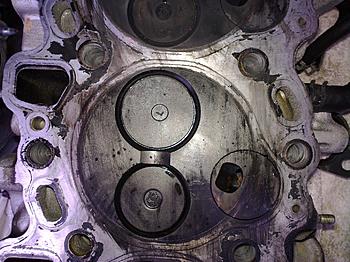

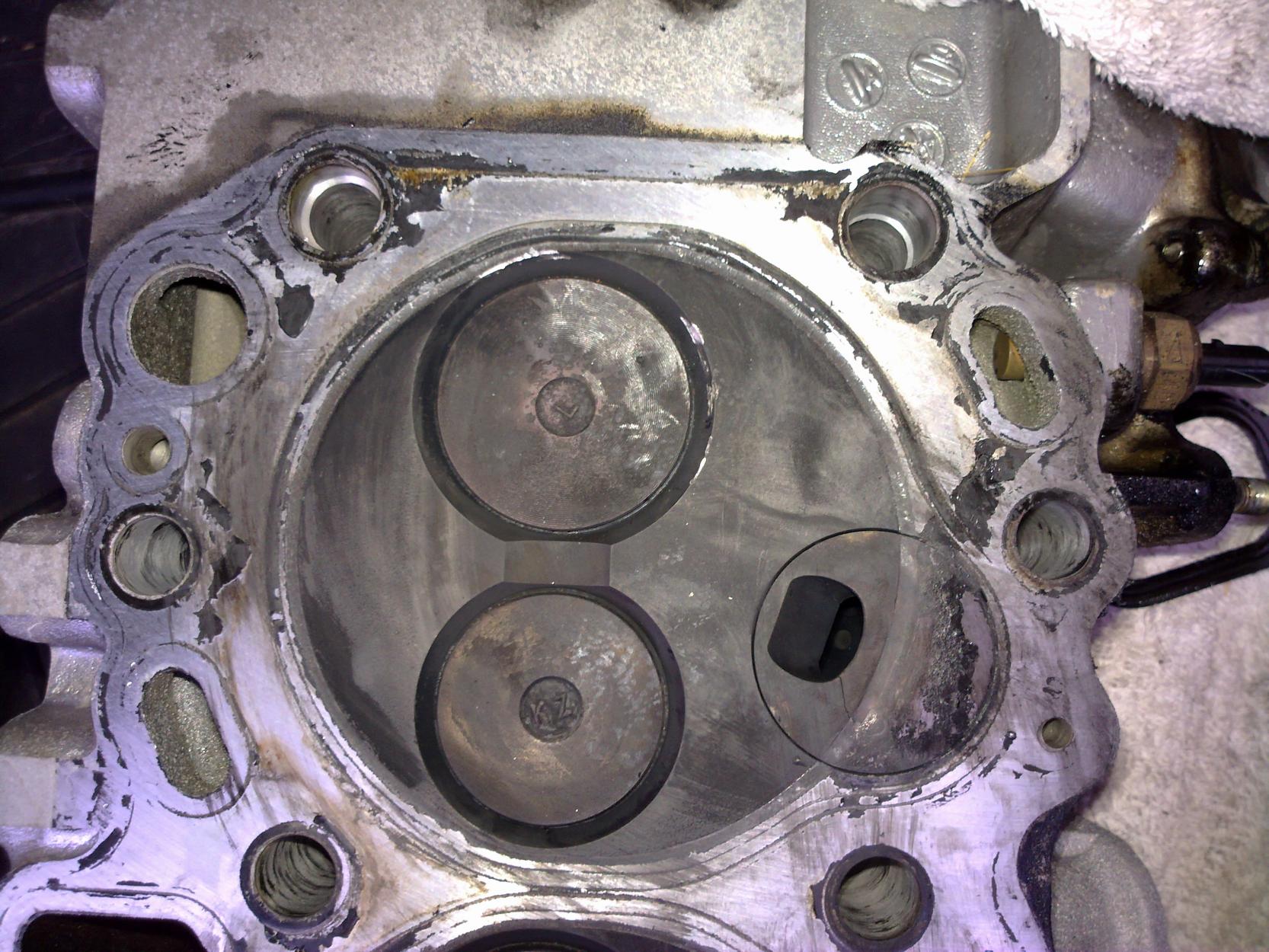

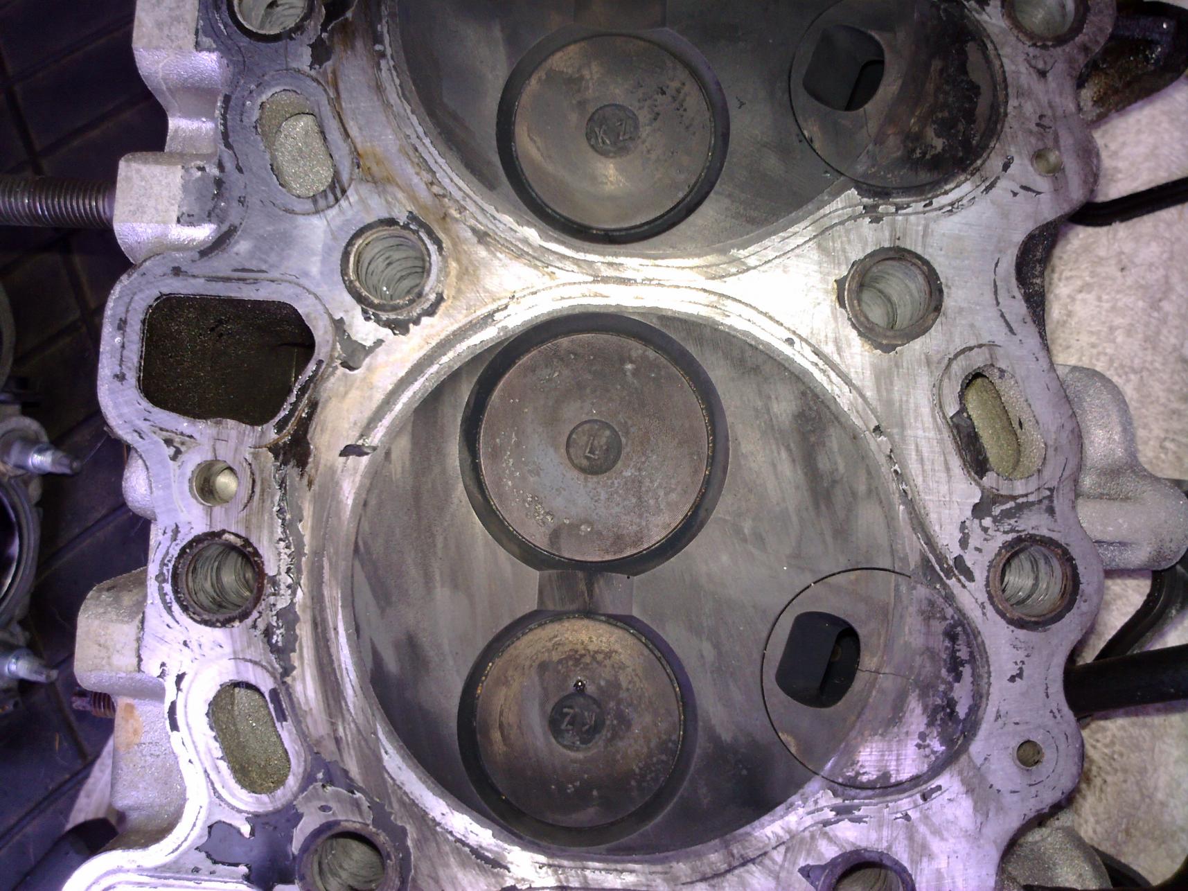

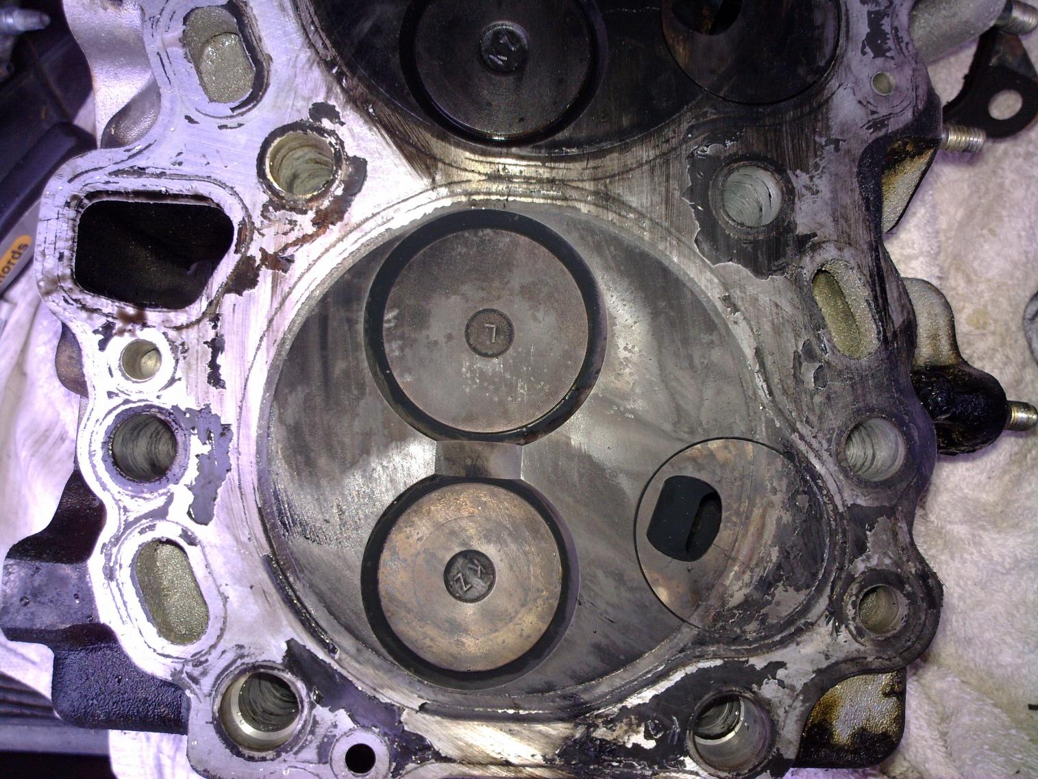

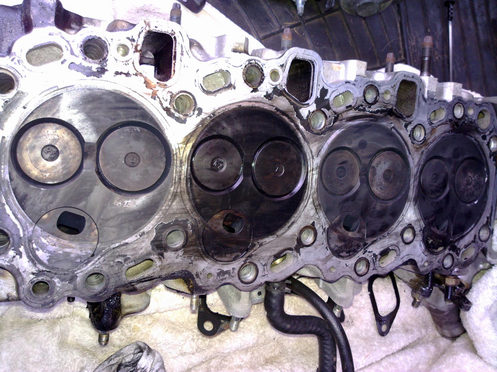

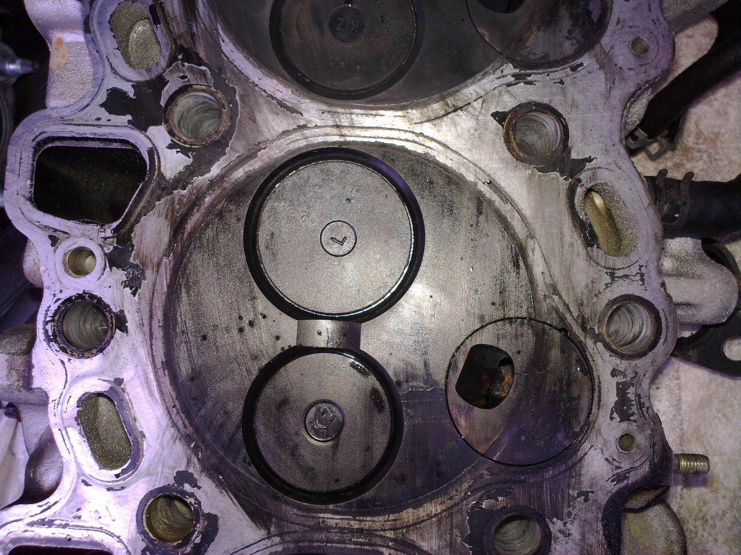

clean up between the valves with a little solvent, take more pics and post again, the only cracks visible to me there are on the injector seats which I think you can just replace, you might just get away with the head skimming and testing before refitting, mine were highly visible. H

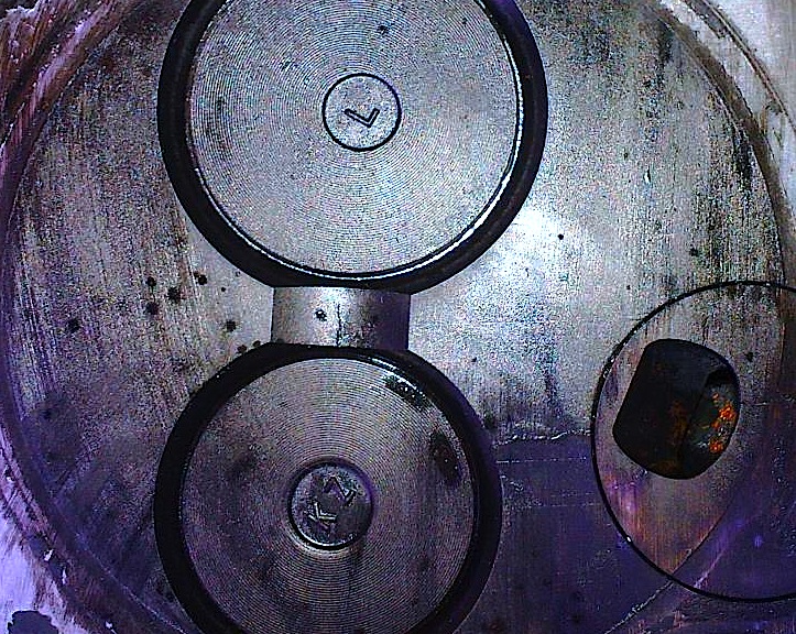

whats the mark between the hole and the inlet valve? i presume the hole is where the glow plug is situated never having taken a diesel engine head off before i can only assume thats what it is, if it was a petrol head its where the plug would be
No thats the combustion port, the injector goes into head above that.Originally posted by soramad View Postwhats the mark between the hole and the inlet valve? i presume the hole is where the glow plug is situated never having taken a diesel engine head off before i can only assume thats what it is, if it was a petrol head its where the plug would be
.Alan
so with that crack between the valve ports is it scrap metal?

thanks for that i have never owned or worked on a diesel engine before, but know my way round petrol engines as i used to race them years ago , webber 40/45dcoe's, piper cams,gas flowing heads etc yep years ago nowOriginally posted by KERRSURF View PostNo thats the combustion port, the injector goes into head above that.
If its deffo a crack then yes its scrap, depending where you buy another head from they'll want the old one intact from you, they reuse valves cams etc on the built heads. HOriginally posted by Surfsupdudes View Postso with that crack between the valve ports is it scrap metal?

been working like a dog, but I will have a closer look this weekend, as memory serves I am sure it is a crack, although I need to clean the head up and have another look, just want to say thanks Hazzo for helping me, I would have been up Sh1t creek otherwise mate.Originally posted by Hazzo View PostIf its deffo a crack then yes its scrap, depending where you buy another head from they'll want the old one intact from you, they reuse valves cams etc on the built heads. H
