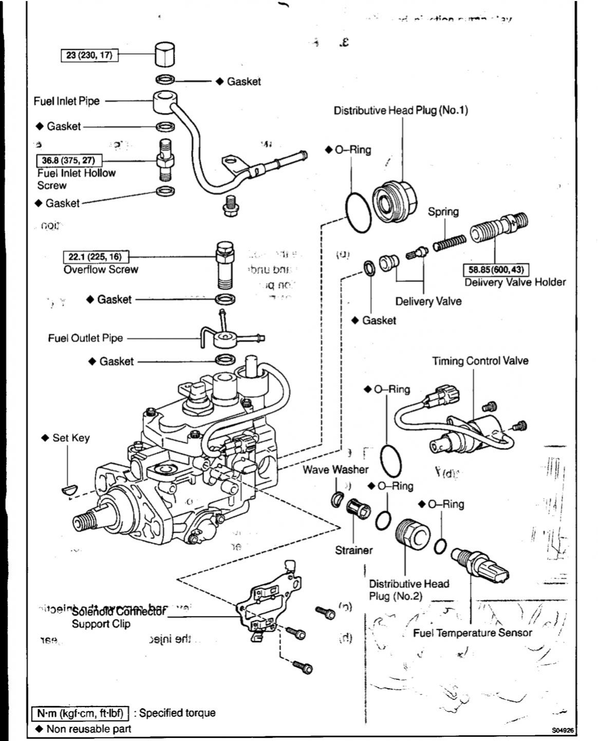

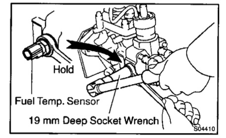

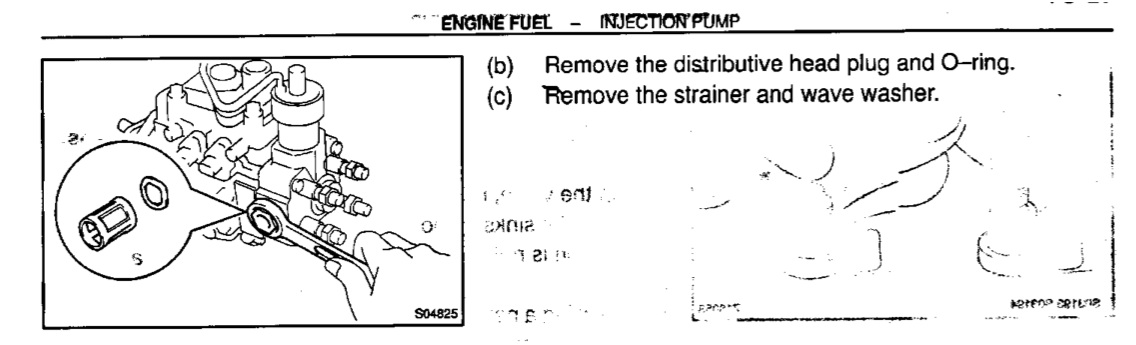

Took out wee filter as described by Rich, little bit of soft gunk, nothing really, cleaned off the fuel temp assembly and replaced filter, when we at first unscrewed this from the side of pump only a little fuel came out, when wee gauze filter came out a lot of fuel did too.

I just noticed I put the wave washer in the wrong place, it should be behind the filter and not in front, it's so thin, surely this couldn't be the cause?
I'll put it in the right place tomorrow.Alan
wouldn't have thought it would effect how it runs, its just won't have sealed the filter properly thats all.

Yeah, but if you're answering my post I was talking about the Spill control valve.Originally posted by KERRSURF View PostIs it just 2 screws that hold the timing control valve in then?
Its on the back of the pump pointing up, its in the pic but not labelled.
The timer control valve will reliably show a fault code if duff, its often hard to fix on 2.4's with a used pump often only answer.
