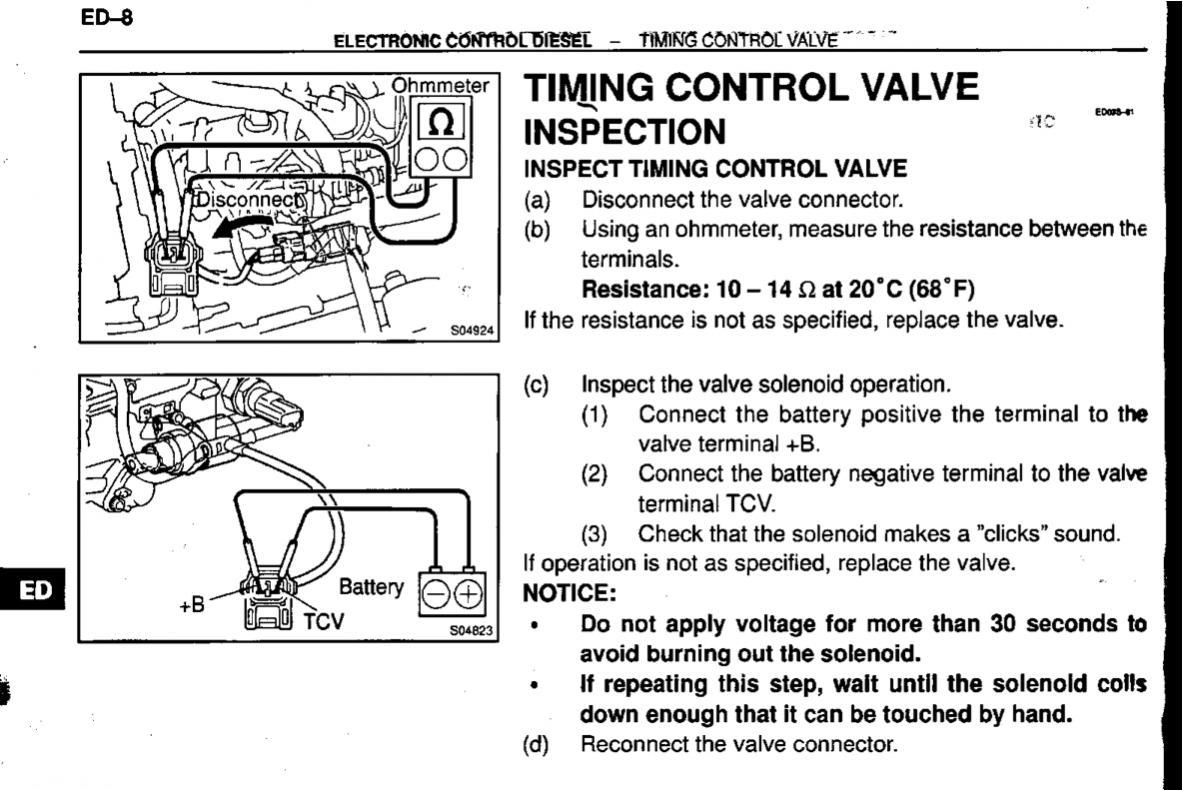

Now, I tried unplugging the plug in the pic below with ignition on and then plugging back in, no click from solenoid, is my Timing Control Valve perhaps to blame and could it work intermittently?Alan
It could easily be. Not to sure how the TCV works, if it actually shuts of fuel, or just alters the injection timing.Originally posted by KERRSURF View Post

I checked/cleaned all connections to pump. check timing valve control solenoid was operating with battery power, check vac pipes again, cracked injectors, tested resistance readings on each plug. Fuel coming up to pipe ends, engine cranks, tries to fire but won't catch.
