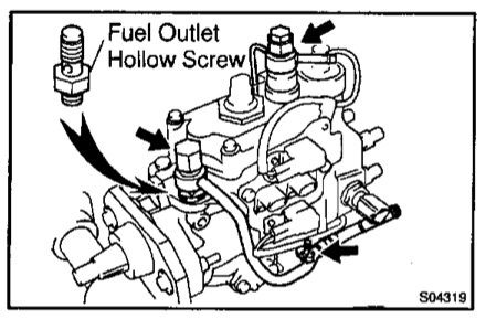

                Are you talking about these Rich, I did the front one on priming and I got fuel here, didn't know about the other one until I read your post and looked at the manual online.
                    thats the ones i was on about yes.
