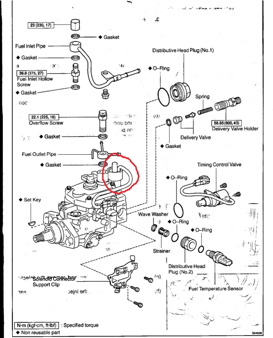

Originally posted by TonyN View PostYeah, but if you're answering my post I was talking about the Spill control valve.
Its on the back of the pump pointing up, its in the pic but not labelled.
The timer control valve will reliably show a fault code if duff, its often hard to fix on 2.4's with a used pump often only answer.
Tank vacuum as Vince mentioned in other post is a good one, try it without the fuel filler cap on.
Also, not idling and running rough is often the shutdown valve staying on while truck is running, double check all the hoses in the other thread that I answered, and try reversing the two hoses to the UFO shaped bit. The valve could be trying to choke the motor if its working backwards.

Thanks for that, the SCV is the one with white plug sticking out the top of pump yeh? when I get the nut off how does it come out, I had that nut off the other day and it still felt solid.Alan
Originally posted by KERRSURF View PostThanks for that, the SCV is the one with white plug sticking out the top of pump yeh? when I get the nut off how does it come out, I had that nut off the other day and it still felt solid.
What you had is the engine RPM sensor.
I had to buy a big spanner, grind it thinner and cut and weld it to a different angle to get in there.
But Ricksurf found a viscous fan hub spanner fits easier, from a Ford or something, its in one of his link above.4x4toys.co.uk - Keeping you on and off the road...
Is it the part labelled distibutive plug No1 on this diagram Tony?
http://www.hiluxsurf.co.uk/forums/at...7&d=1279491944Alan
Right I'll need to fab a spanner to fit that.
