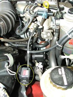

    Hey Vince ya don't have a picture of it do ya mate ?

          is that the sensor in vinces pic?
          • #20
            Nope, its on the intake as it goes into the exhaust manifold, the other side from the throttle cable, and is worked by the throttle flap rod as you press the go pedal. Round black thing, with a elec plug on the side, pointing downwards.

              got any pics so i'm sure of what i'm looking for
              • #22
                Its adjustable, it twists from side to side, try moving it either way as it might just be off the contacts under full throttle.

                    According to the EPC you do not have a TPS on the Venturi for an '89 model.
