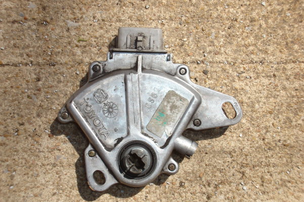

                          Could be a clue there to your problem.
                          Is the multiplug (8 or 9 wires I think) firmly connected on the transmission next to the shift linkage?
                          The plug connects onto this....
                          • Originally posted by BUSHWHACKER View Post
                            Hmmm is that easy to change as looked at it today and hid in a corner and wimpered
                                Where is that!!!!! i will check, is that attahced to the big lump of cabling i keep pushin out of the way to get to kickdown cable on gearbox
