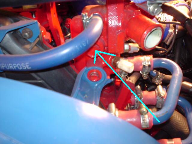

I tapped mine in one of these inline dohickys, (first pic) but if you want to tap in before the stat you can get an adaptor to fit into the blanked plug (second pic) that'll give ya temp reading as soon as the water starts heating
