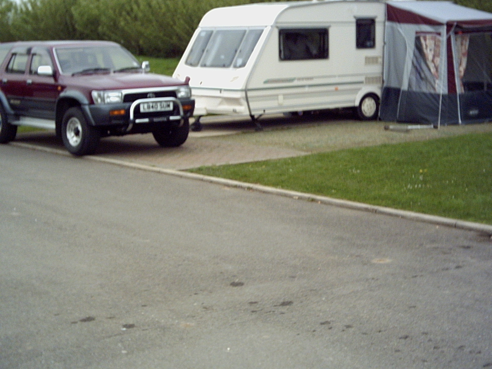

Marky sorry for the long awaited reply with regards to the alko hitch problem i had.............. anyway to cut a long story short ive sorted it. what i have found is that after getting the van in position i let the car reverse litterally an inch make sure the springs are in the hard mode (which is how i tow) and then wind it off and it just comes away easy, the reversing bit is the trick really as you release the bushes slightly.............
