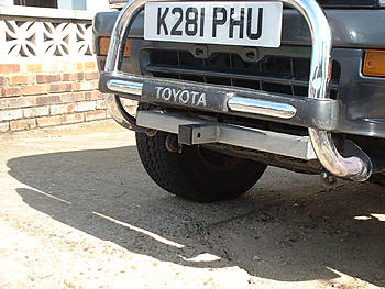

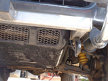

            Droplate.Tow ball. Arrester Bar.
            The first two pictures show the way in which I consider to be safe for my towing needs.
            Vehicle specification: Second gen wide body 2.4 desiel.
            The rear has been lifted 2" by means of longer coil springs.
            I have welded together two 4" drop plates giving a total thickness 20mm.
            The 4" drop plates were used to achieve a tow ball height of 17". The correct height for my Bailey Pageant.
            The reason for using two is the extra strength, with which I feel happer with.
            The plates are bolted on the top two holes and a second pair of holes that I transfered thru from the tow bar. (4 nuts and bolts in all ). The tow ball as can be seen are bolted on the lower holes of the drop plate along with the stabiliser fitting ( snake master ).
            While I am not happy with the looks of this set up I'm cofident it is strong enough. It could be said that lower strech bars to the chassis or tow bar side plate bolts would not go a miss.? or even change my stabiliser to an AL-KO (yes please, money permitting ). The electrics have been fitted to the bumper so that the tow ball and associated plates can be removed for off roading.

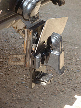

            The second two pictures are of an arrester bar that I fabricated. For those people who have not seen one before it takes in my case, a tow ball.Its very handy as the peple in my street are not at all helpfull, when it comes to parking with regards to getting the caravan on my drive.
