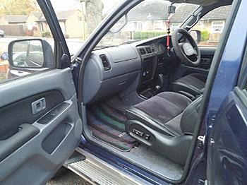

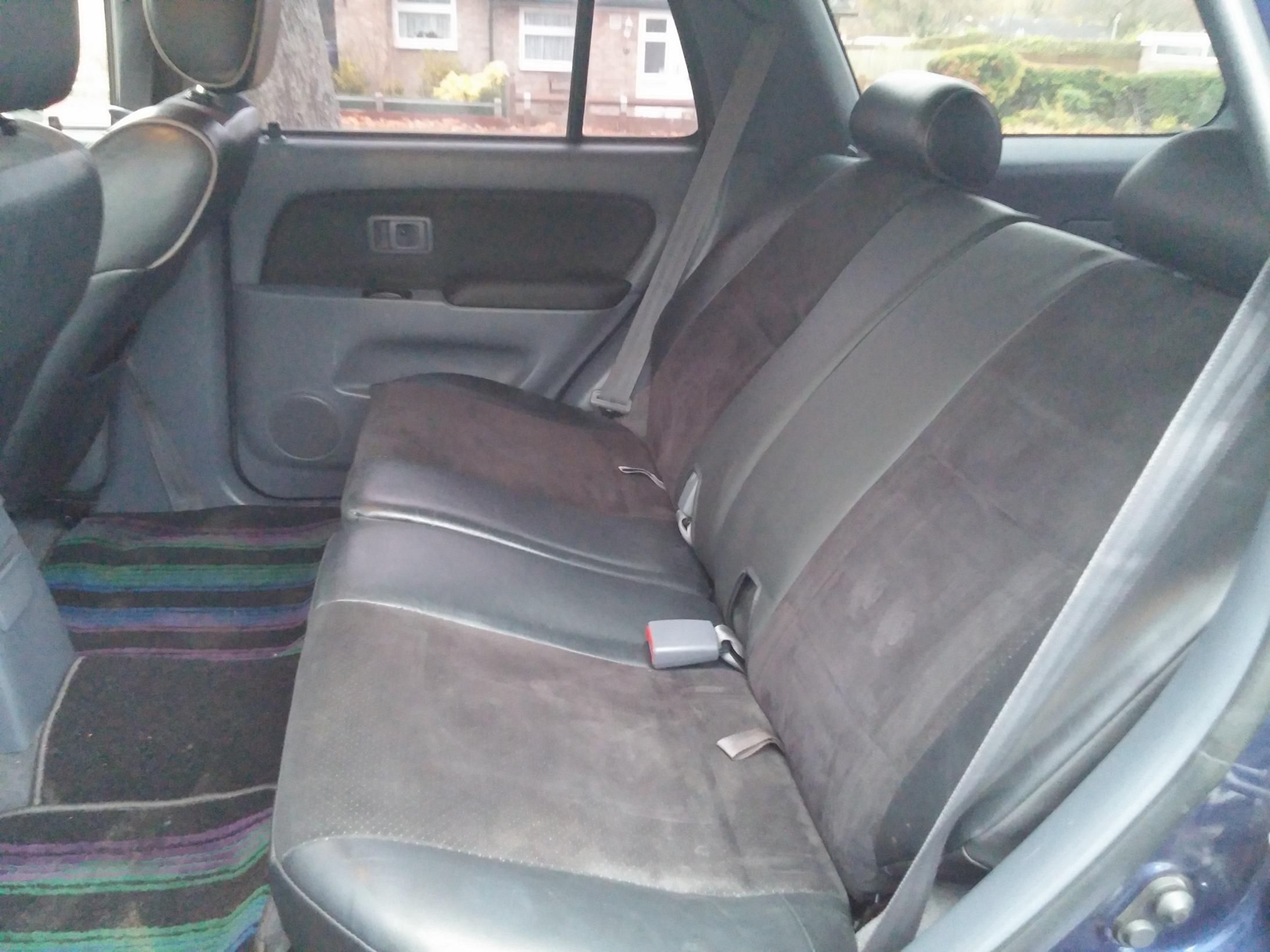

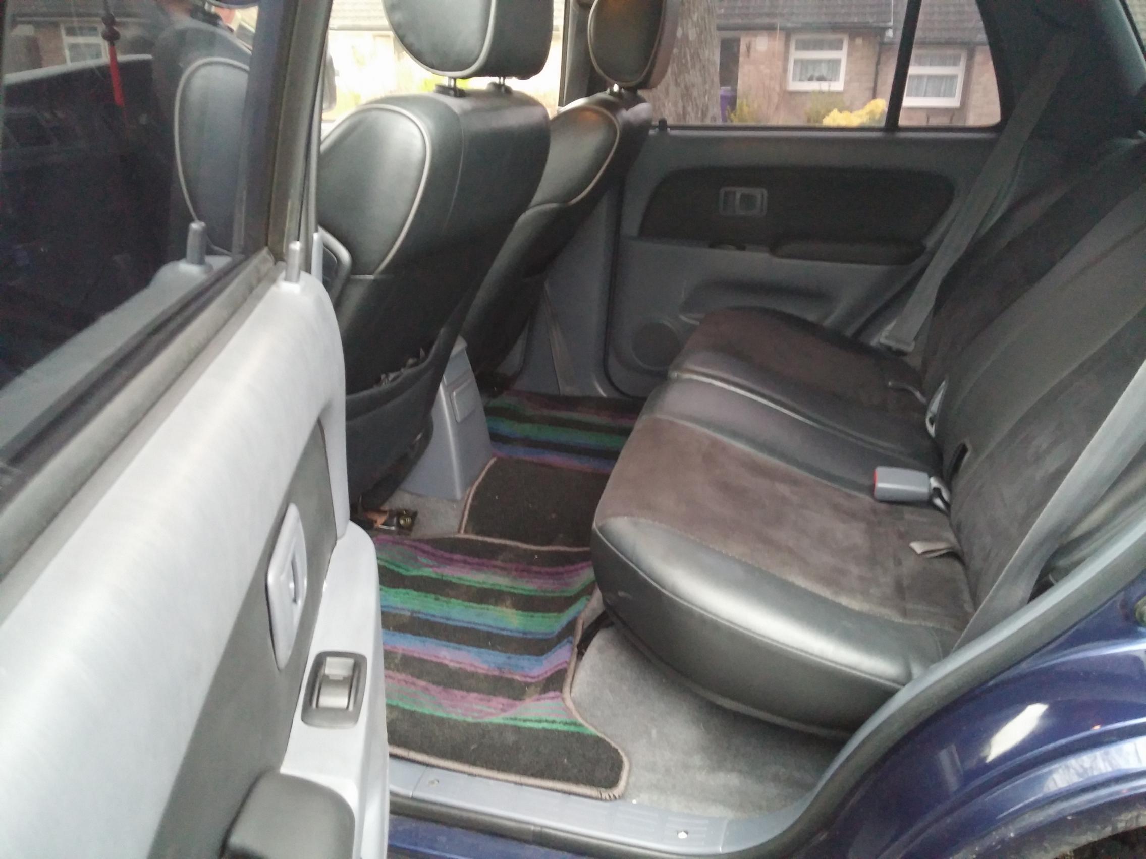

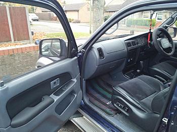

[QUOTE=J i m s t e r;800798]Picking up some is200 seats and cards tonight, rear bench looks like it has a load-through centre.  I'm only after the fronts to be honest as the foam in mine is crumbling out at a prodigious rate.

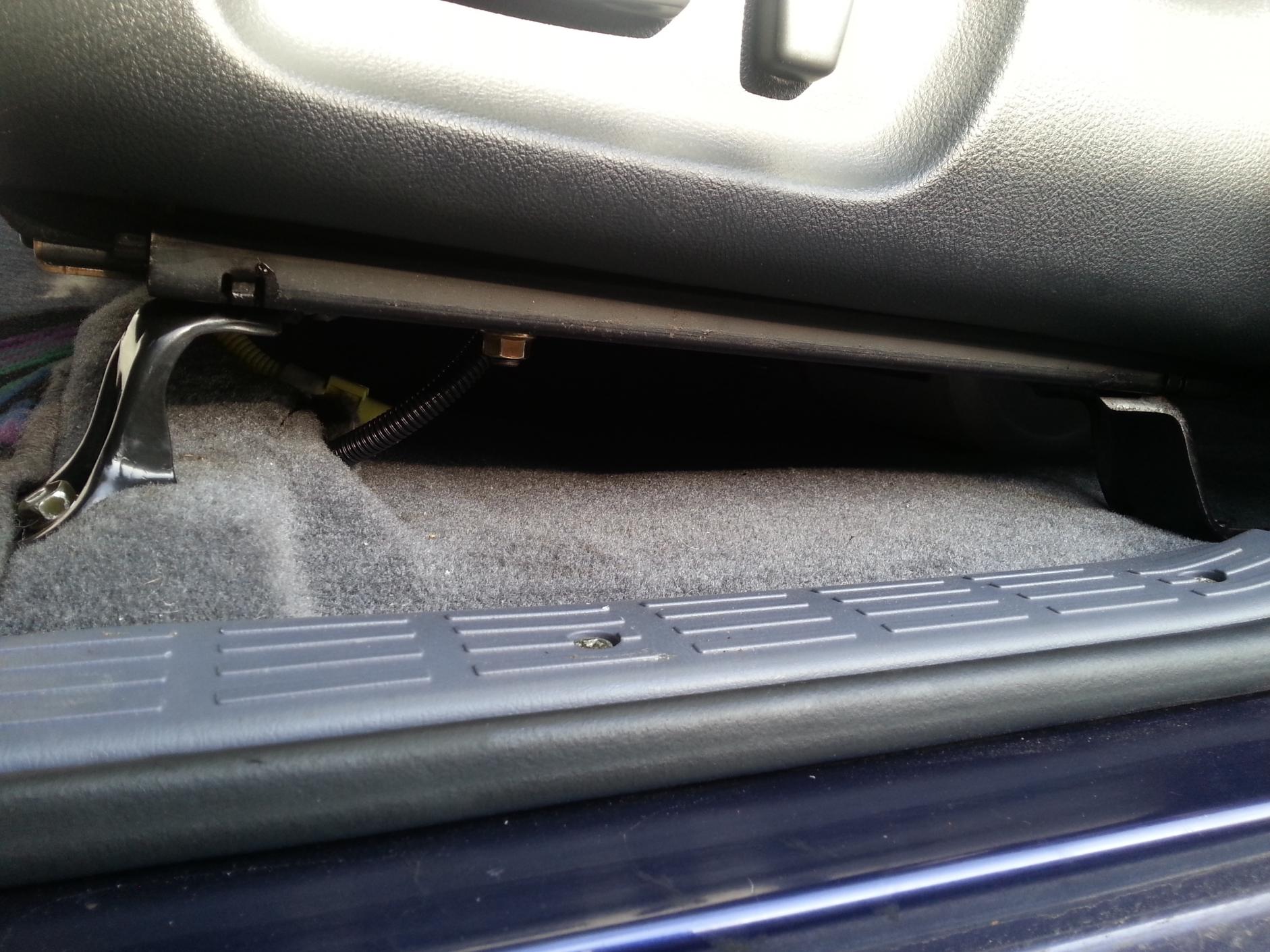

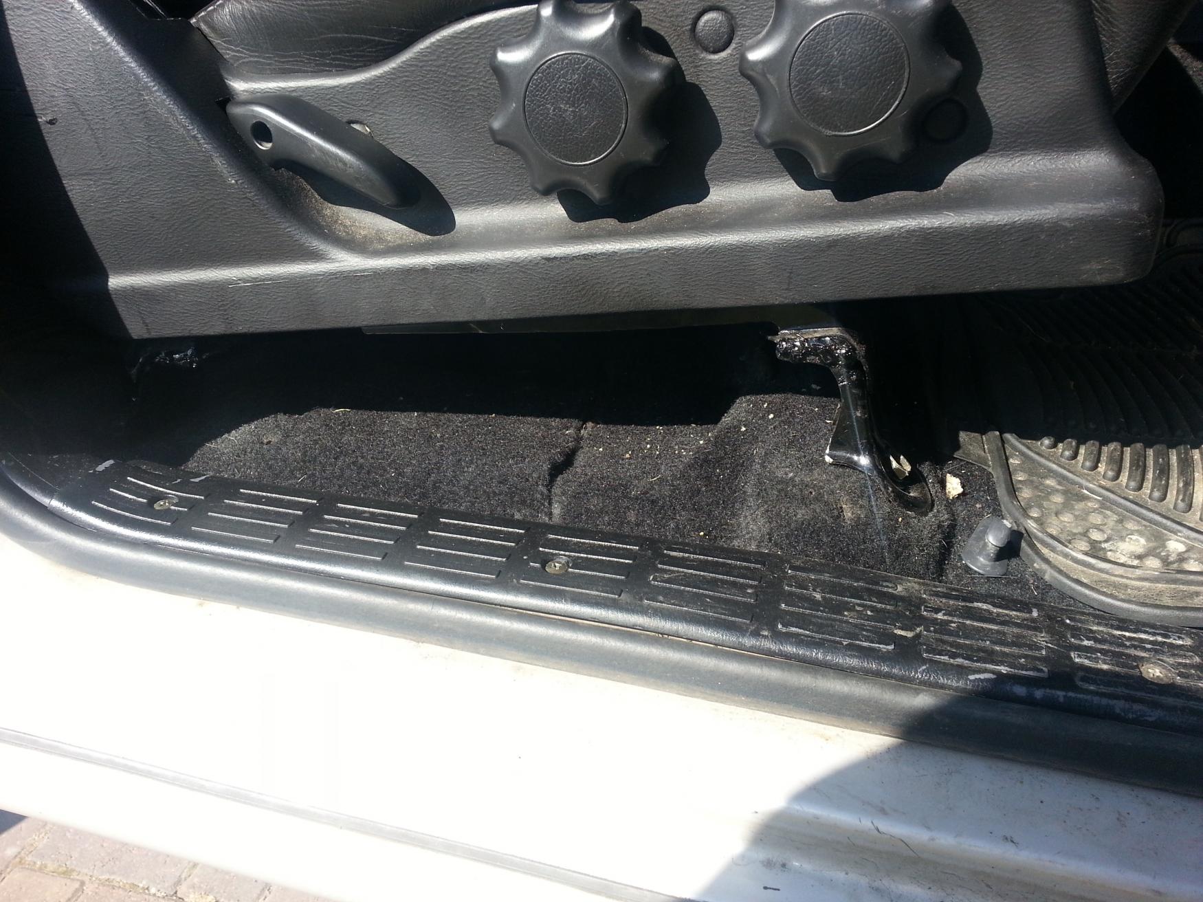

Can you up some photos of how your runners have been fitted? Mine is also a 3rd Gen.
Jim.[/QUOTE
I will get some pictures done next week, gotta take them off to redo a couple of welds i wasn't happy with
Jim.[/QUOTE

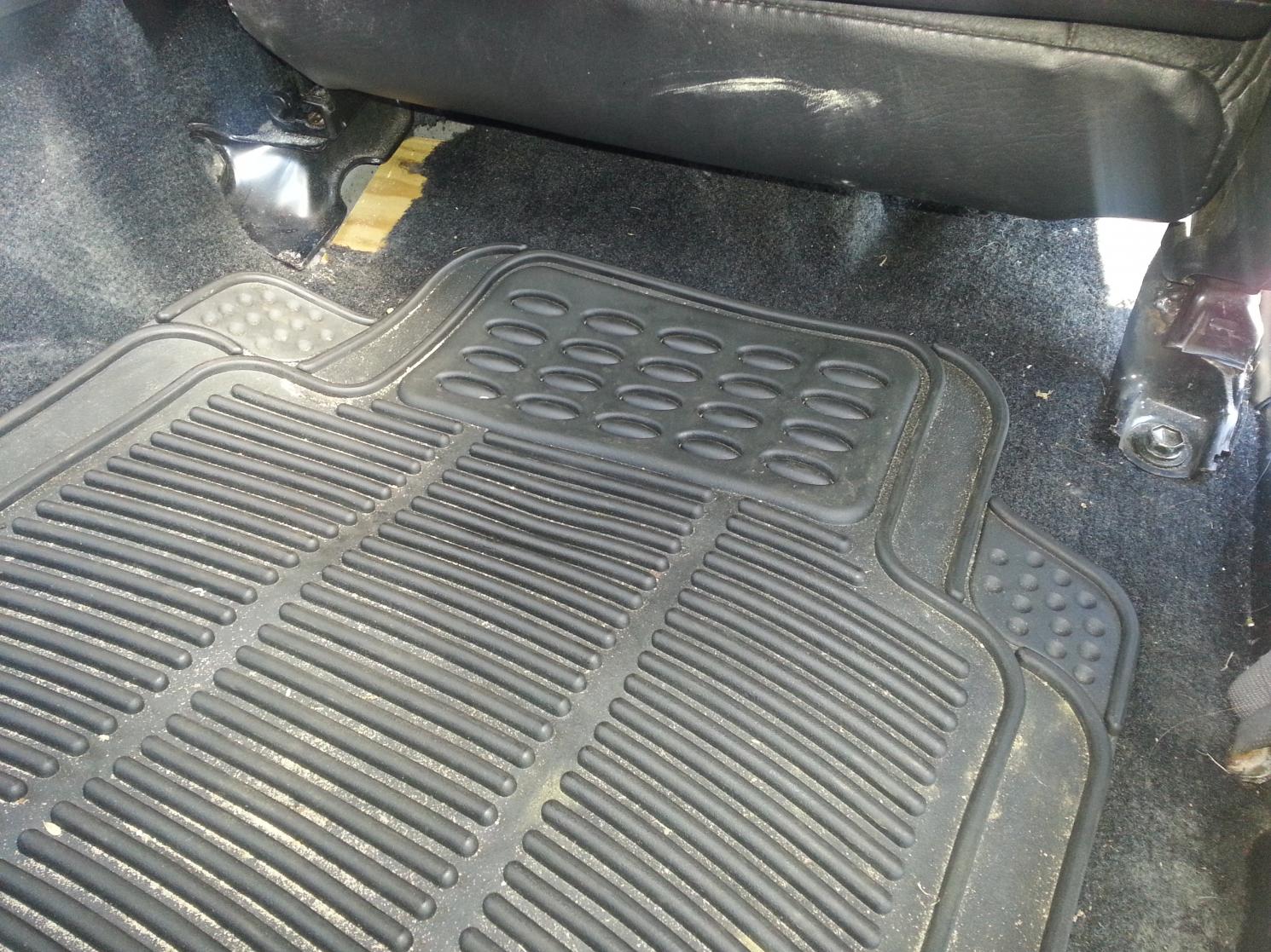

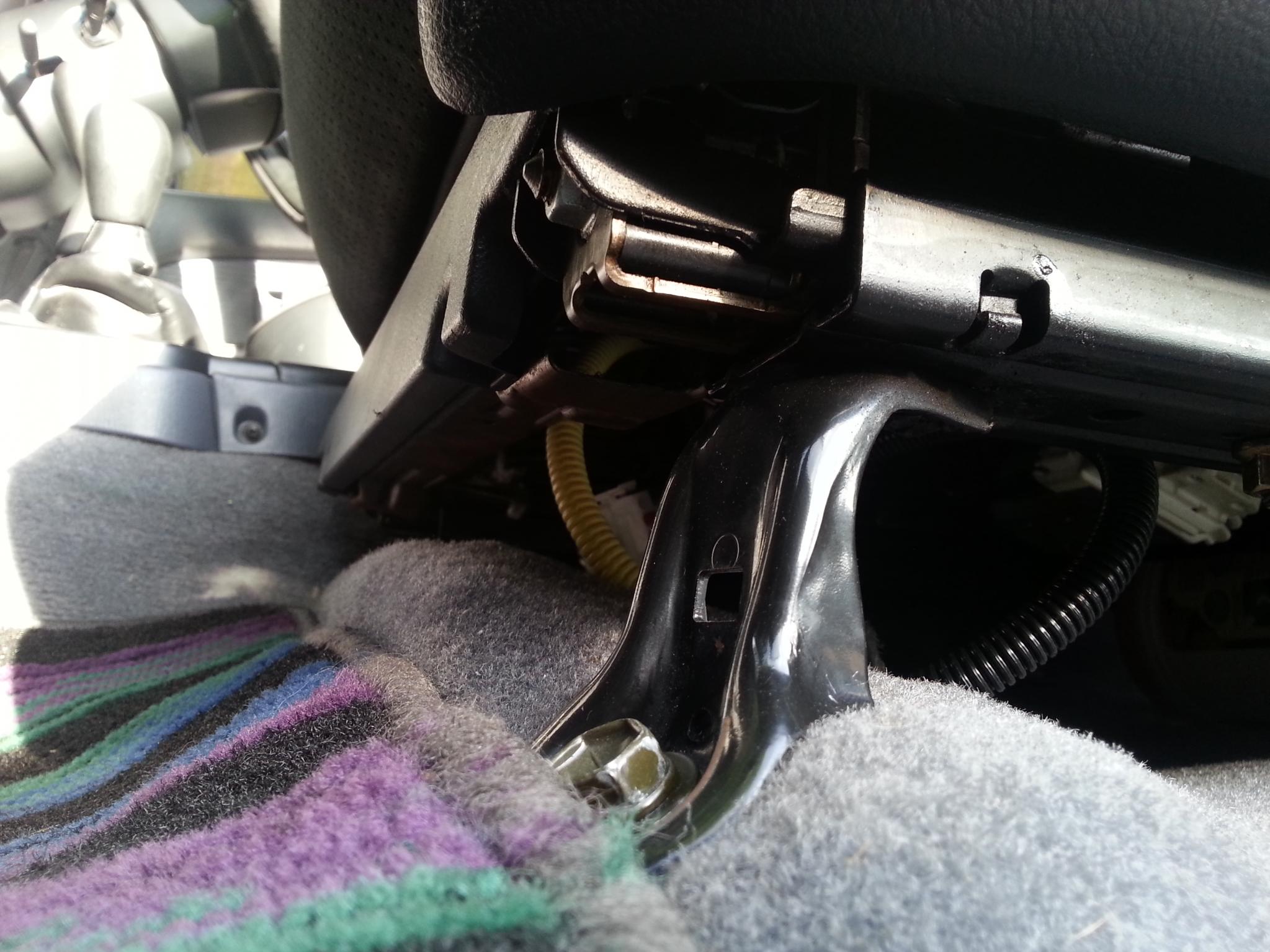

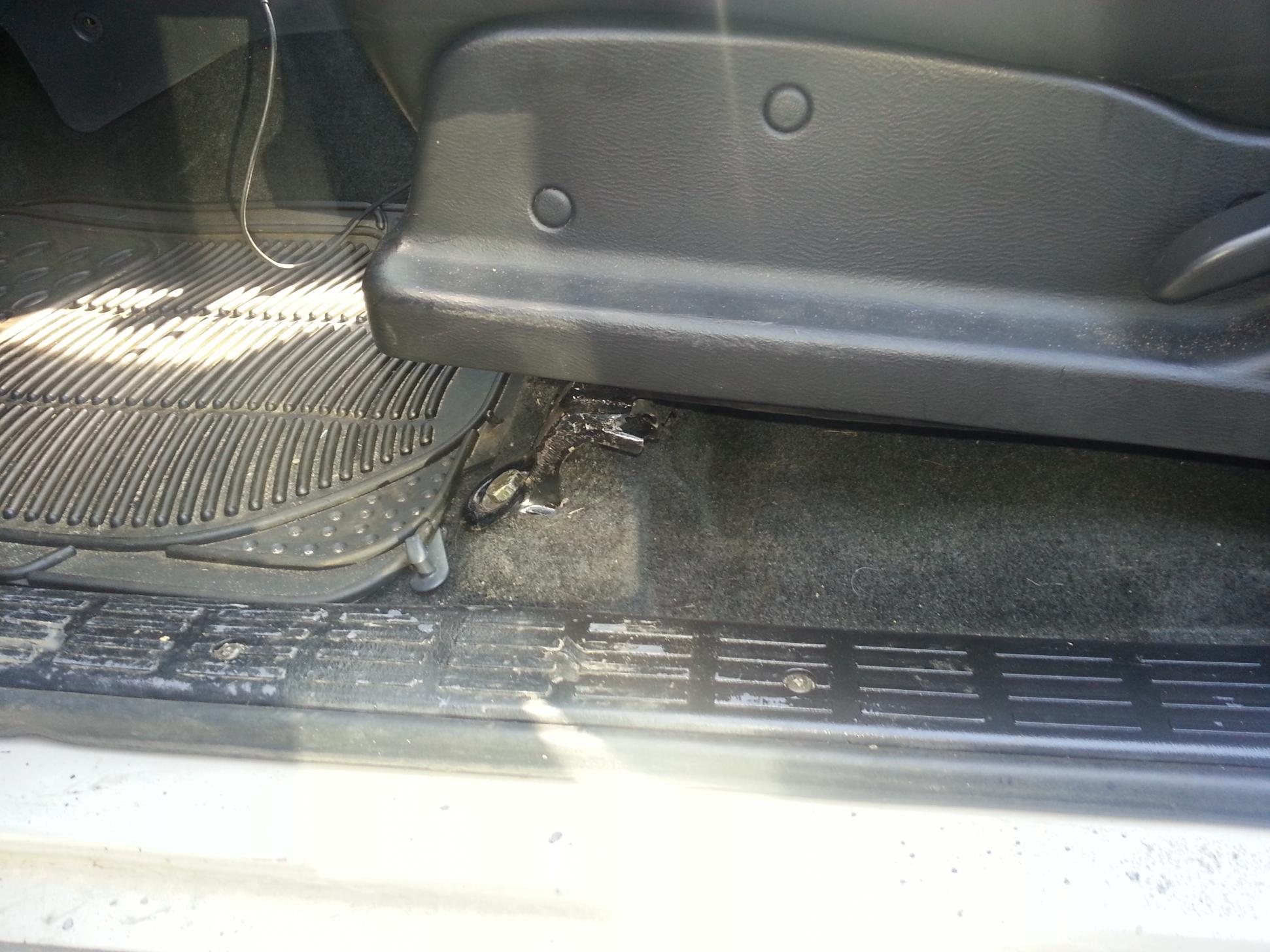

 , i removed all the legs from both seats and then reused at least one hole on each runner/ leg to re- mount surf legs to the lexus runners and then trial fitted with nuts n bolts adjusted the rotation of the legs on the runners until seats were strait n lined up with everything, i then tightened bolts through the legs so they wont move and then welded up.
