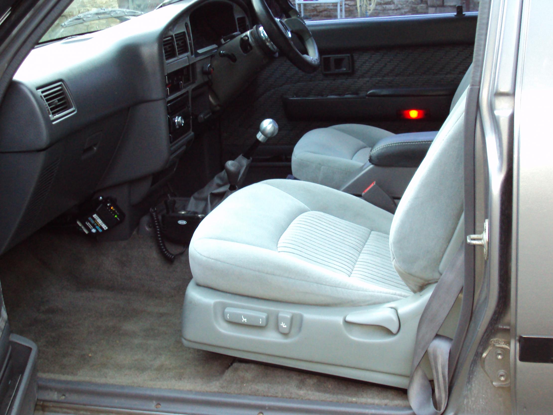

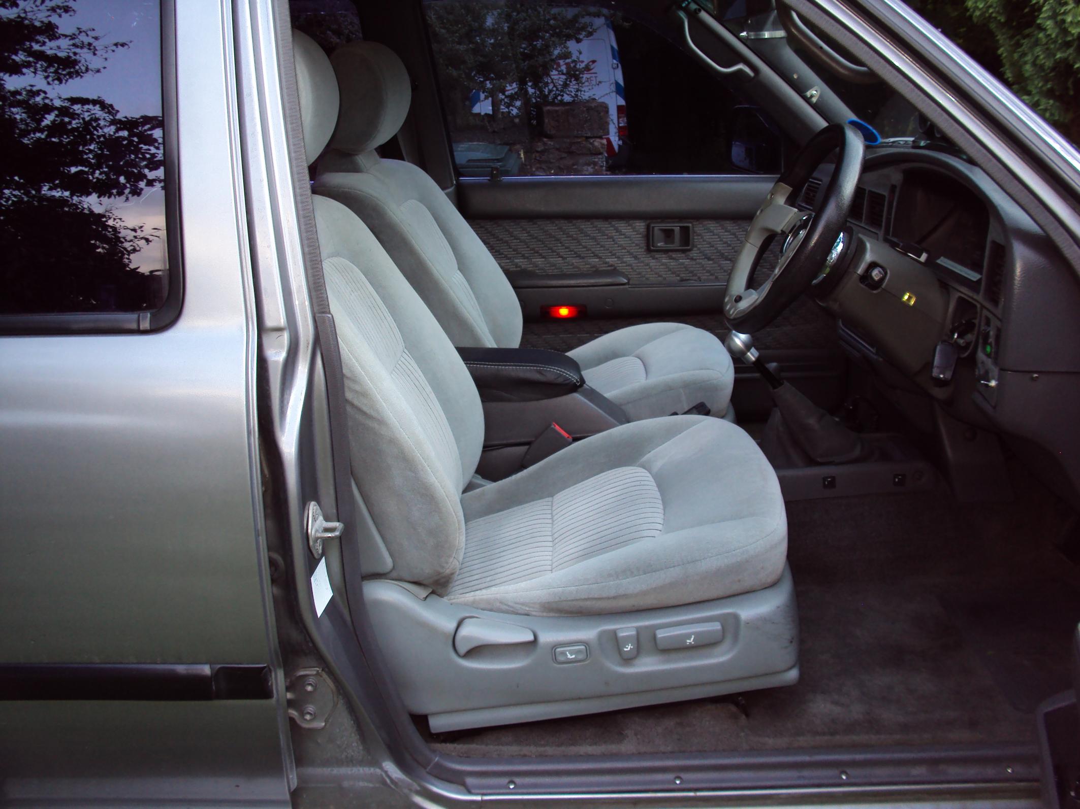

I drove up to Hamburg last December and then up to the Baltic coast and was thinking, would'nt it be nice to fit some real quality seats with all the adjustments at your fingertips? Two weeks ago i travelled up to north Wales accross country and after three hours driving i made the decision to swap the seats. I managed to get the two front seats from a Lexus Soarer, which have all the adjustments via electric motors and bearing in mind the ride height, the seats have to be fairly low profile to keep the head room of the original seats.
Well the conversion worked a treat with the minimal of alteration to the runners.
the front two are in line but had to be bent 90 deg and the rear required one hole to be re-drilled. 30 amp feed from my secondary fuse box that i fitted for my accessories and i now have a really comfortable fully adjustable set of seats!
