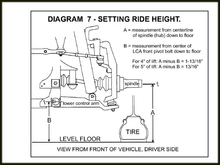

One further one, you will also need a full front end geometry adjustment done afterwards or you will eat the inside edges of your front tyres very quickly. Lifting the suspension by any measure will increase negative camber on the front wheels, making it very twitchy at the front. Mine is being properly set up by Steertrak on Thursday.

Over 4 inches of suspension lift will bust your CV joints unless you drop the front diff. I've got manual hubs fitted with a 4" suspension lift. The driveshafts are at a horrendous angle on that.
