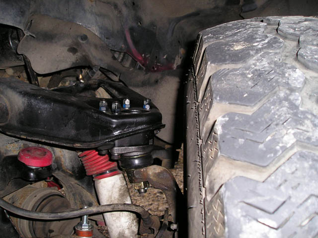

The list just goes on and on. Once you start it's hard to stop. Sicne i didnt get a great lift from my Procomp springs (around 1"), when i put my front balljoint spacers i will have a big of a slightly saggy rear end again, albeit 6" higher than 2 years ago, so i have ordered some 1.5" Daystar coil spring spacers from these guys.
www.truckcandy.com
Of course if i put the spring spacers in, i am going to need extended brake lines and a panhard rod drop bracket. You see what i mean. This cheap lift is turning out to be a bit more expensive than i thought!
www.truckcandy.com

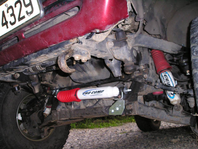

I would definitely recommend the Ball joint spacers to anyone, but get manual hubs beforehand or your cv's will pay the price. Probably would not recommen d the procomp steering stabiliser. Have noticed a little difference between it and the old one but not as much as i thought, i mean its over twice the size! Overall i'm very happy with everything and the stares keep coming.
