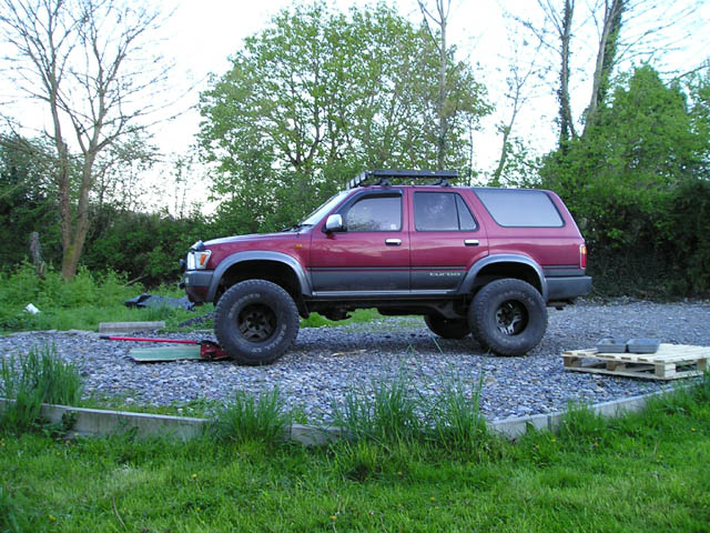

I'm in the process of doing a 2" suspension lift on my Surf and i'm getting quite excited about it.   I have nearly all the pieces.
- 1.5" Balljoint spacers for the front
- 2" Procomp Lift Springs for the back
- Got some second hand 33x12.5r15 Courser Radial Lt's
- And just ordered four 15x8 Chrome 8 spoke steel wheels
Will fab up a bracket to raise the LSPV arm after the lift to bring it back to normal. I will probably do a write up on this one, if anyone is interested ). Will use this thread for updates. Combined wth my 1" body lift and a slight torsion bar crank, i will get 3" of lift and probably another 2 fom the tyres.
  I have nearly all the pieces.- 1.5" Balljoint spacers for the front
