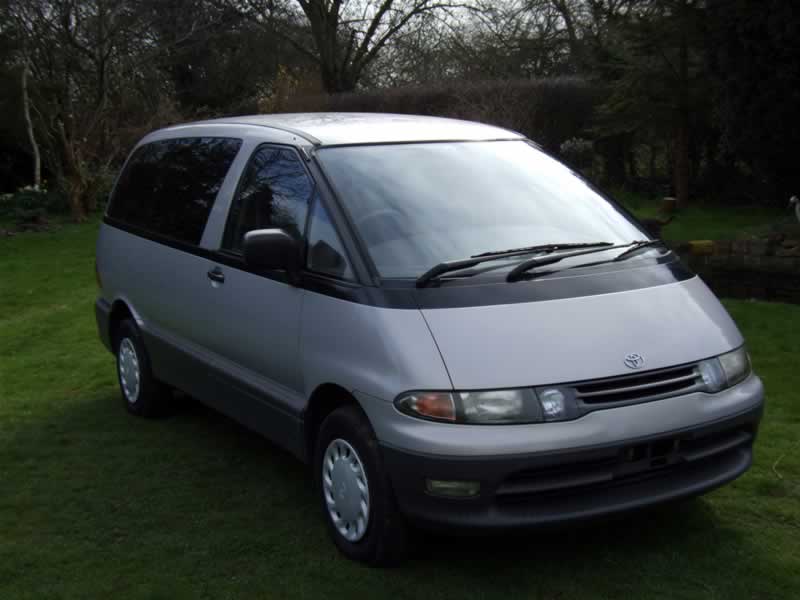

Don't forget that other Toyota import, the Estima has the same 2.4 engine as the Surf so look out for these as well when at the breakers.
