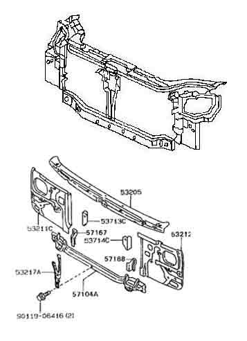

The V6 shell has a different front panel. You can buy the diesel slam panel as a separate item but the V6 one is only available as part of the complete front.
