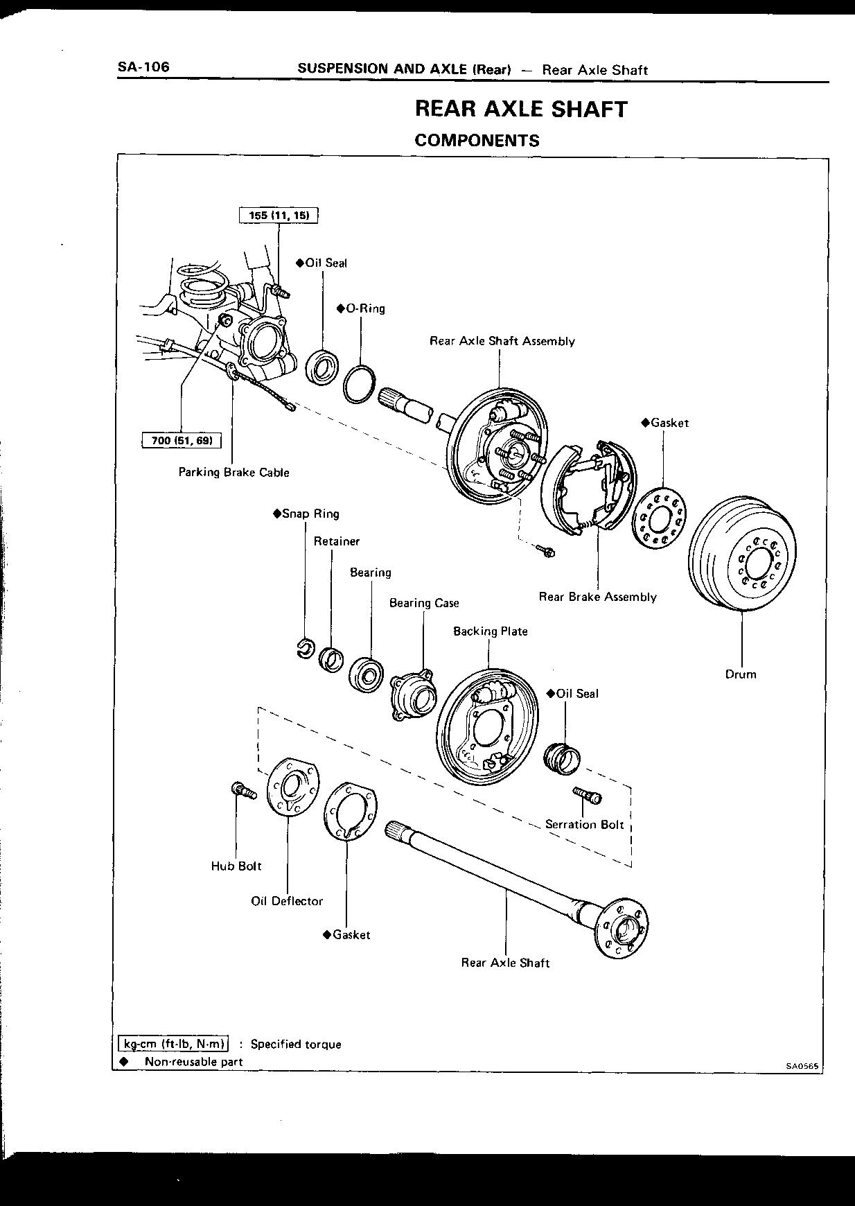

1996 3rd Gen Passenger side rear hub is making awfull squeaking/rubbing noises.
This started off being intermittent but is now constant.
Have had the rear drum off and wheels turning and is definately coming from the hub itself. There is no play in bearings when trying to wobble the wheels, this makes me worried as it is an LSD axle.
Anyone any ideas as to what to check bearings or whatever before taking it into the Toyo garage..............me thinks this is going to be costly
