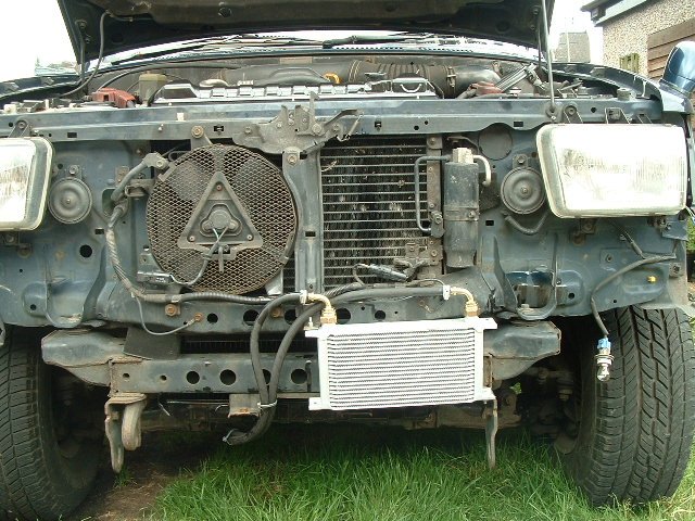

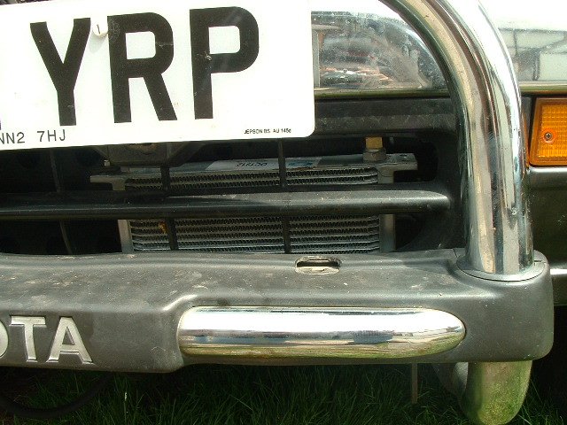

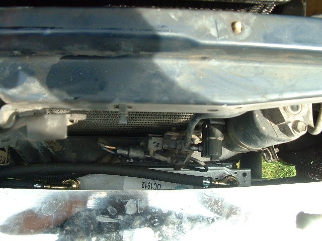

                      Done it at last!
                      I`ve finally done my rad/auto oil cooler mod and yes it does seem to make a difference, i tried the same bit of road as before at high speeds in yesterdays heats and the gauge didnt move! The oil cooler was hot to the touch but it didnt burn my skin off and the oil temp warning light didnt come on.
                      I had to buy the following to do the mod -
                      Have the Bottom tank of the rad removed and the oil cooler extracted - £41, this was done by my local radiator repairers Leicester Radiators. They were very helpfull and it only took them a day including repainting the rad although he said the cooler was a pig to remove.
                      19 row PMA oil cooler - £74, also bought from Leicester Radiators. It was the biggest one i could somwhere to fit!
                      2 90 degree elbow unions and 2 1.5 lengths of hose - £15, bought from A1 Hydraulics Leicester. Way too much hose but at least it gave me chance to change my mind where to mount the cooler if needed.
                      Genuine Toyota Thermostat and rubber O ring seal - £13, bought from my local Toyota dealers, they were very helpfull and knew which model it was although it did take 3 days to arrive!
                      A sheet of 1000x500mm Anodised Aluminium gause £20, a B&Q special! We wanted silver to match the bumper but its all they had in and looks quite good and not too much like it came off a Nova!
                      The job wasnt too bad , the hardest was removing the grill without breaking the clips!
                      Hopefully the porblems are cured now, im off the Isle of Wight on Friday to deliver a classic car on the trailer so that should give it the final test, if anyone wants to do the mod, give me a PM and i`ll my best to describe what i did.
