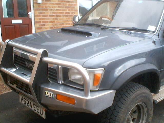

                        why not fit a bonnet vent
                          Only fit it facing forward if its an intercooler . It should face the other way if no intercooler to draw the air from the engine bay , not force it into it against the flow of air through the rad . All that will do is stall the air flow .
                          Cooling fans only work upto a speed of approx 30 - 35 mph and then it is air flow through the rad that takes over the cooling . The air exists the engine bay normally under the vehicle .
                          By fitting a bonnet vent you would give the top of the engine extra venting to allow the hot air out if facing towards the rear .
                          Rick
                            Rick
                            Rear facing vent would also help keep the screen clear of snow etc in winter
