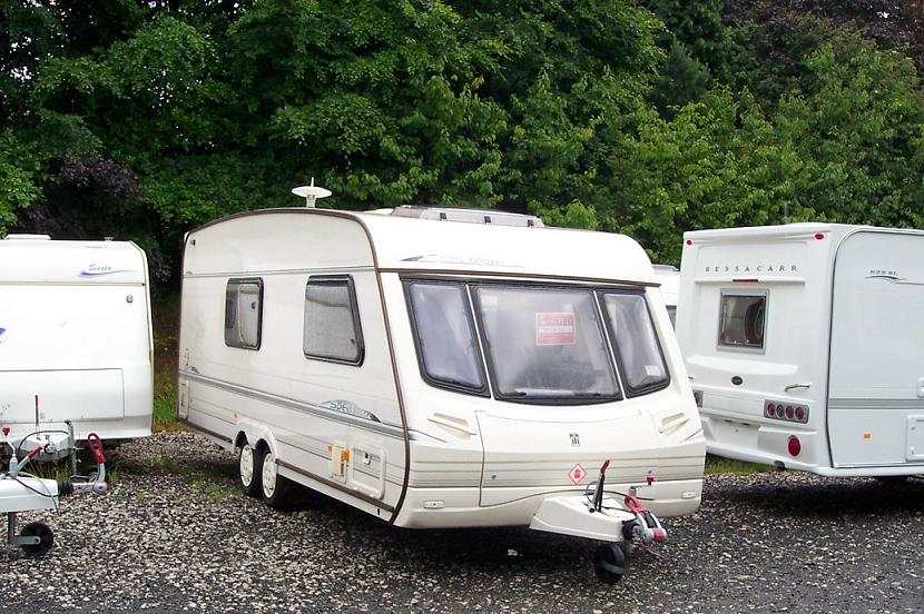

    i was towing 1 1/2 tonne caravan
    • #32
      Marky,
      So not overloaded then? Toy is more than capable of that... Mine just appears to be a little work shy...
