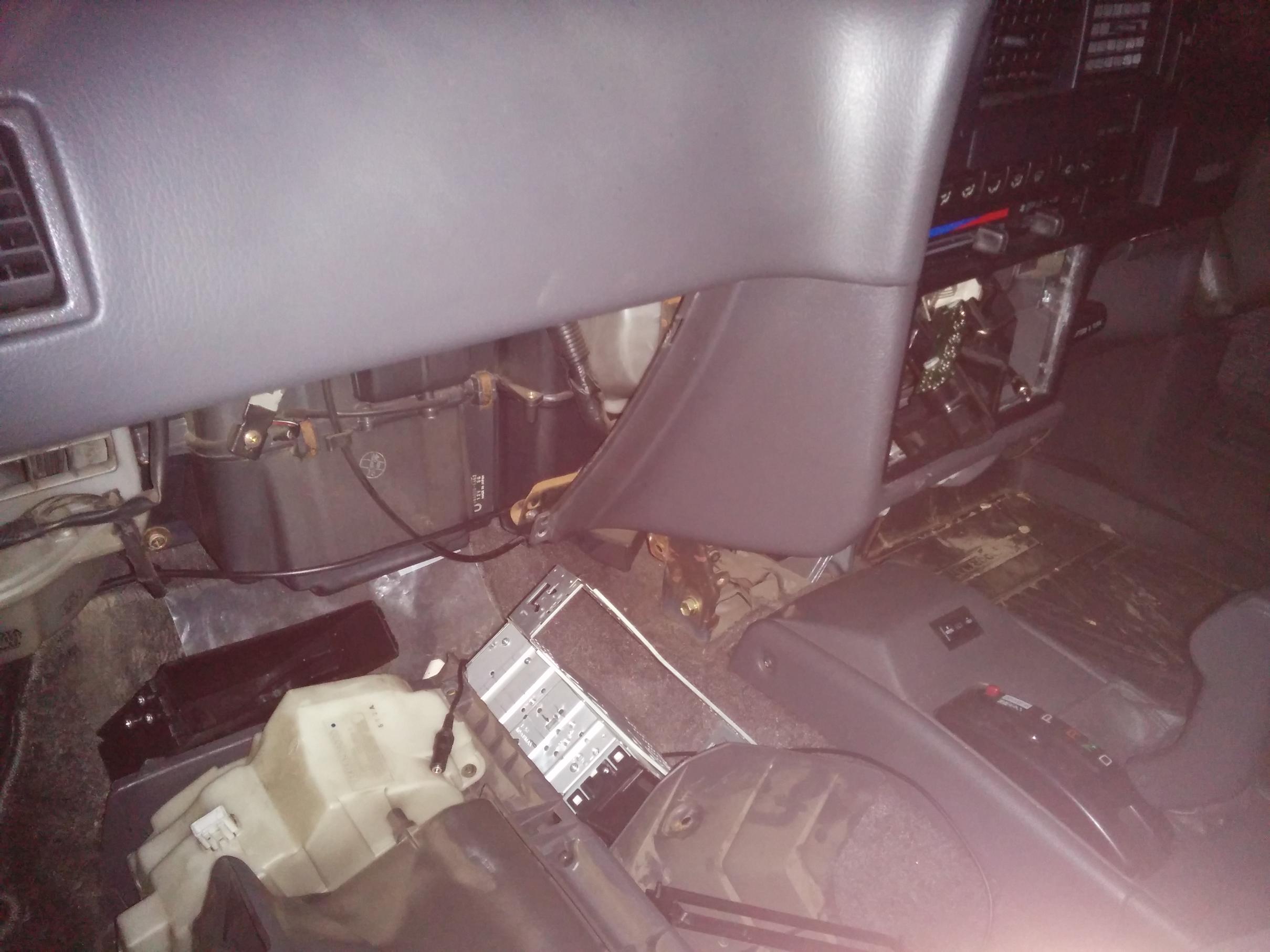

I pulled the dash apart and checked the relays etc, all look fine. No blown fuses etc. I still have heat (but it only comes out at 70mph+)

I've checked the threads on here but can't work out if it's the blower itself, or the heat/blower unit in the dash. Anyone have any ideas on what it could be? Instructions suited for an idiot would be very welcome

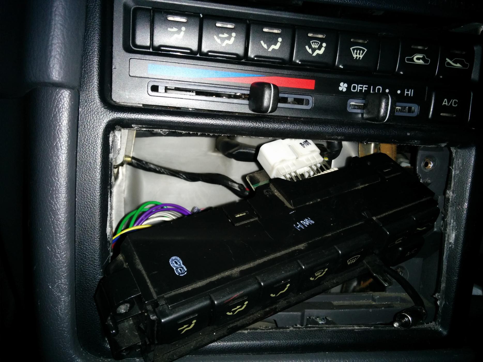

I've got a heater blower resistor being delivered tomorrow, I'm hoping that this will solve my problem (Or I've just wasted £30.) Although I think there's an issue with the blower speed selector as it doesn't have full range of movement it did when I got it.
