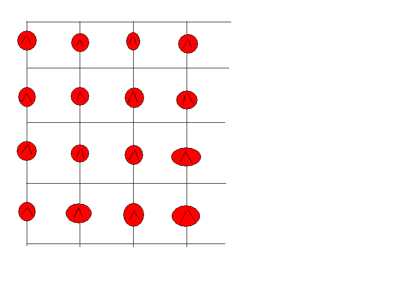

                just as a kinda dodgy semi thought something running through my mind sort of thing, what would happen if for example you had a bank of 16 leds arranged in a square. And sort of wired as in the dodgy picture below, so you have 5 possible wires on the right hand edge you could put either a positive or a negative on, obviously some scenarios none of the LEDS would light - eg if you only had positives or negatives the wrong side of the LEDS, some they would all light up, and some scenaios, ie) a + in the middle somewhere and - at one end only some LEDS would light up, but would any scenarios cause them to all light up at part brightness or could you change switch the polaity of any of the LEDS to get that effect..........
                ........ is anyone still with me or should i just stop thinking?
                    Not at all sure i'm with ya on this but i think any way you connected your feed and neg would only light some of them where ever you connected it, not sure tho, i think all anodes have to connect to anodes and cathodes to cathodes when in paralel, series its like a daisy chain, cathode to anode and so on with a + &- each end,
