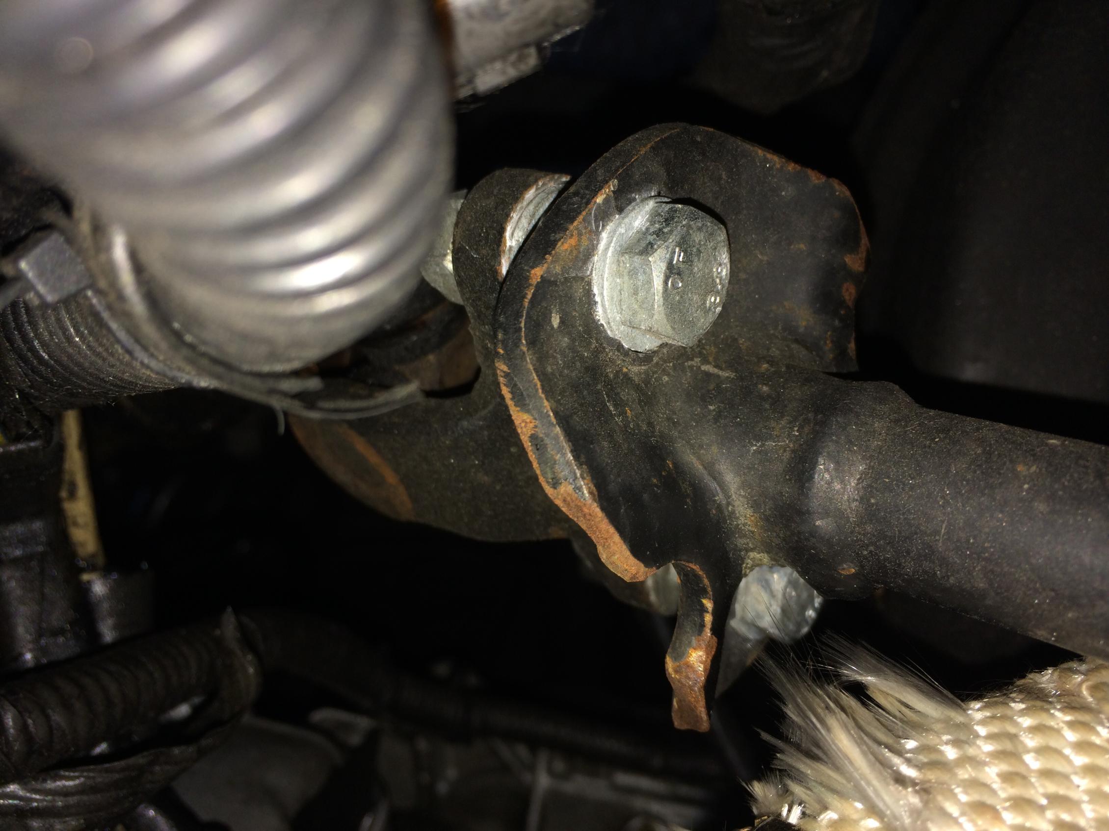

I think V8 Soarer 'Log' manifolds fix that. Or, move the engine back or to the N/S.Originally posted by Reece2.4 View Postengine begins trial fitting phase, so far there is only one problem and thats the steering column hitting the manifoldDo you know that, with a 50 character limit, it's

I had a similar issue with mine, I massaged the manifold slightly and it's also possible to remove the rubber shock part of the steering column and replace with some bolts ill post a photo.ALL THE GEAR!............no idea!

ended up grinding the heatshield bolt hole down so it misses the steering column and moved it over a tad so theres about 10mm gap, theres about 10mm too on the manifold/torsion bars and the cam end/handbrake
