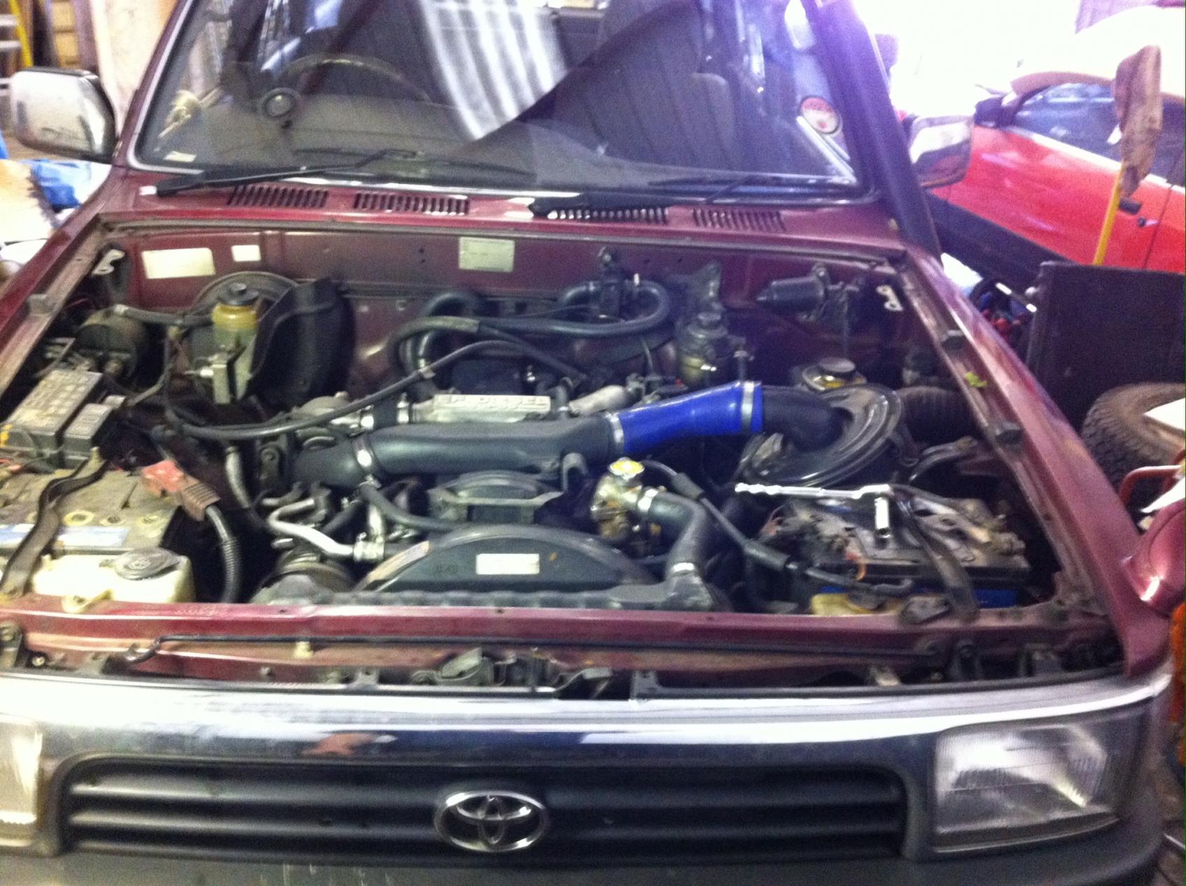

                      Update
                      So yesterday and today I got a fair bit done, removed the smelly oily lump from the surf, removed the gearbox and transfer case, cleaned up the engine bay, drilled and tapped the new bolt hole for the gearbox, cut the output shaft down(maybe 2mm too much!), cut the speed sensor and tapped in the 4mm holes for the grub screws,
                      Quick question for vince, should the speed sensor be as close to the blades as possible or is there a set distance ?
                      Thanks
                      ALL THE GEAR!............no idea!

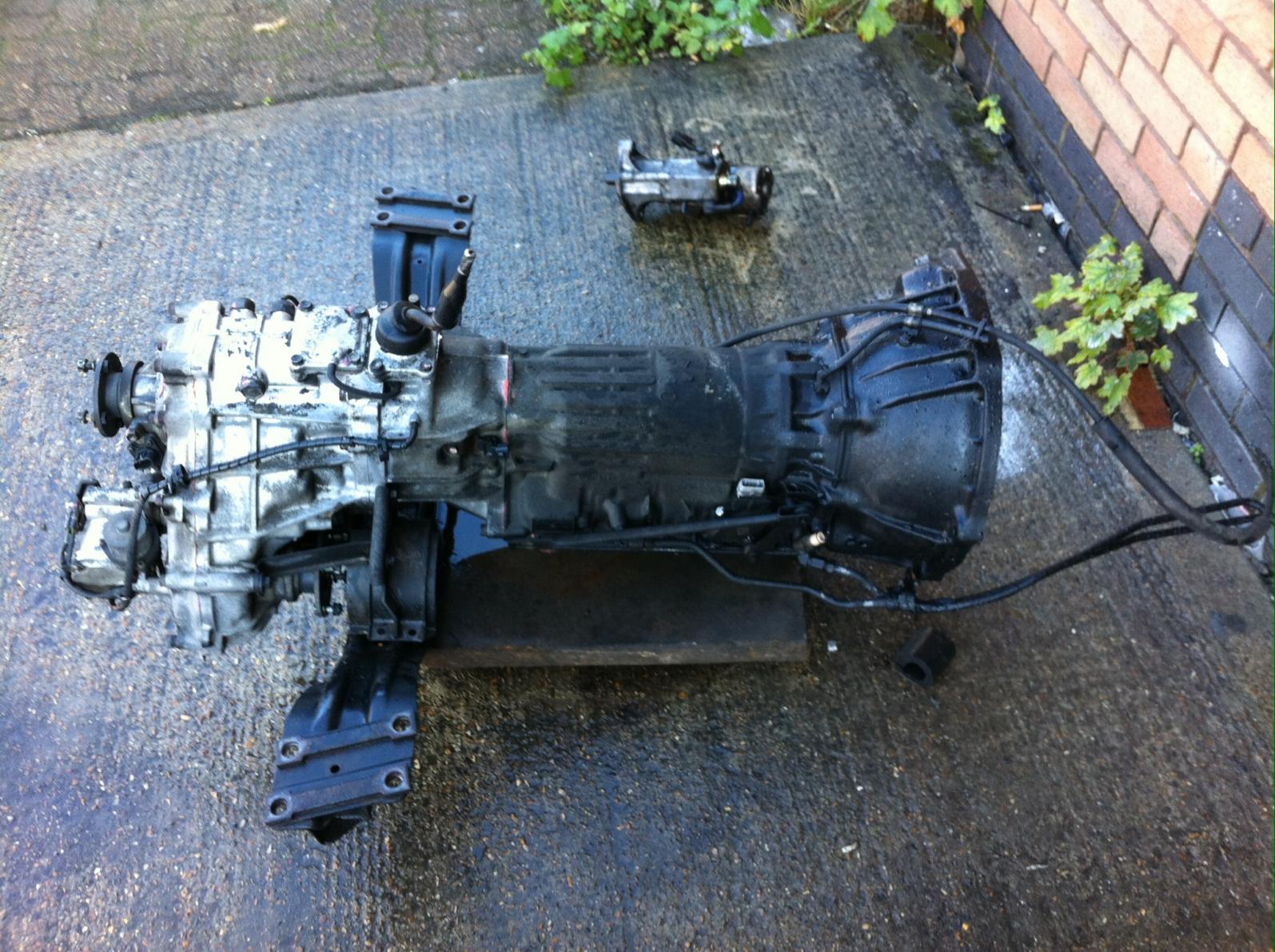

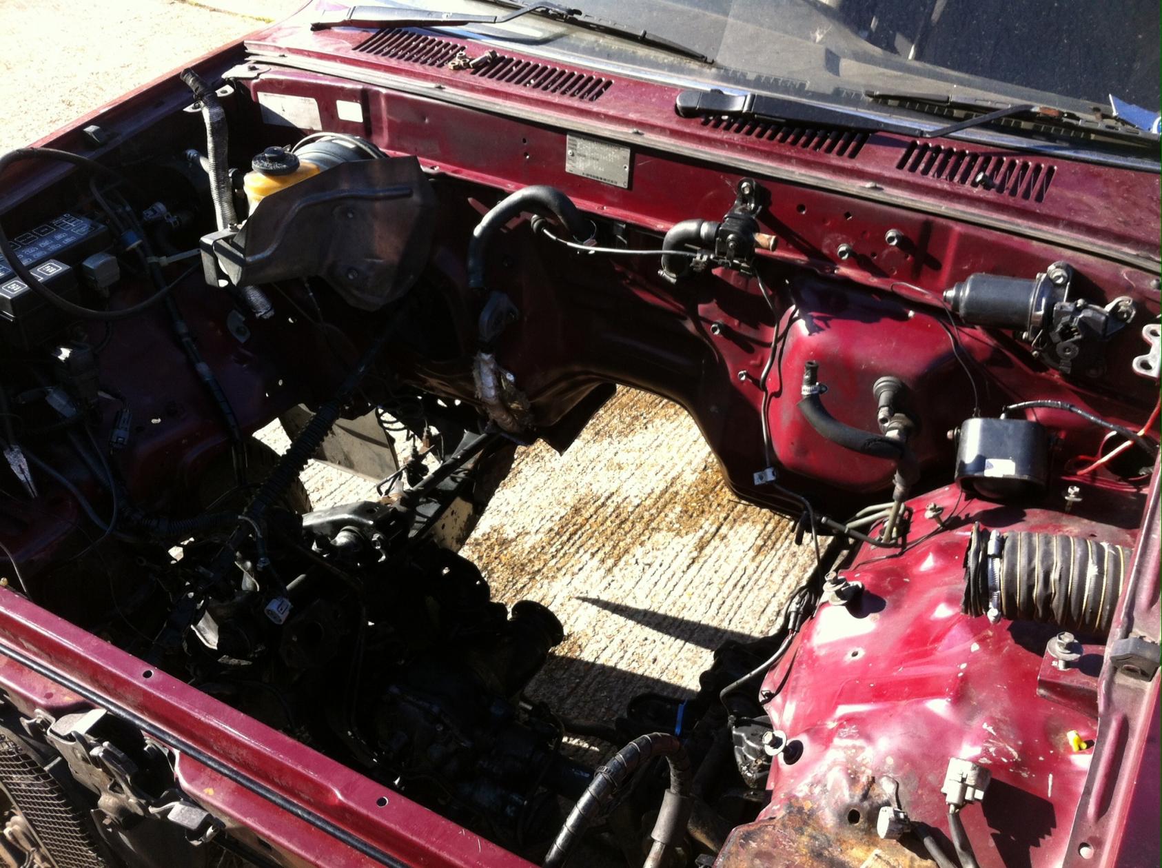

                      • #86
                        After the removal
                        • #87
                          Smelly and dirty

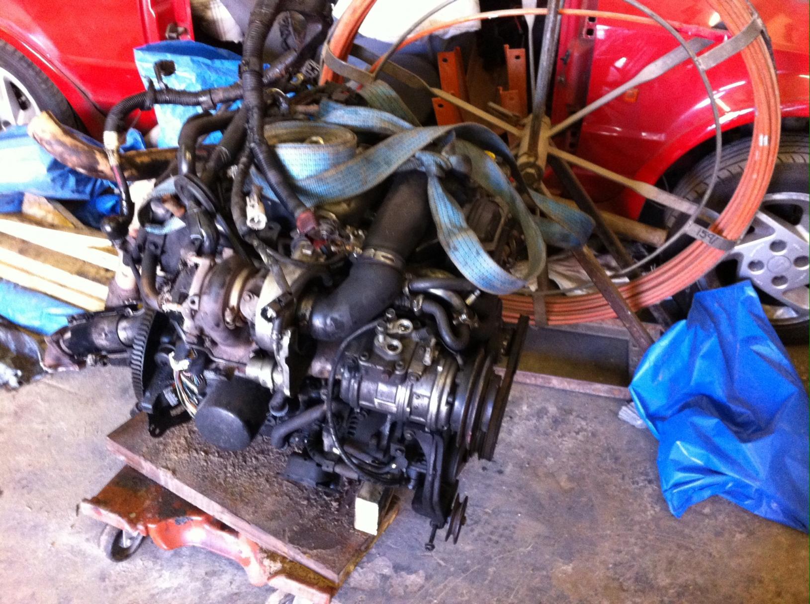

                          • #88
                            Heavy heavy
