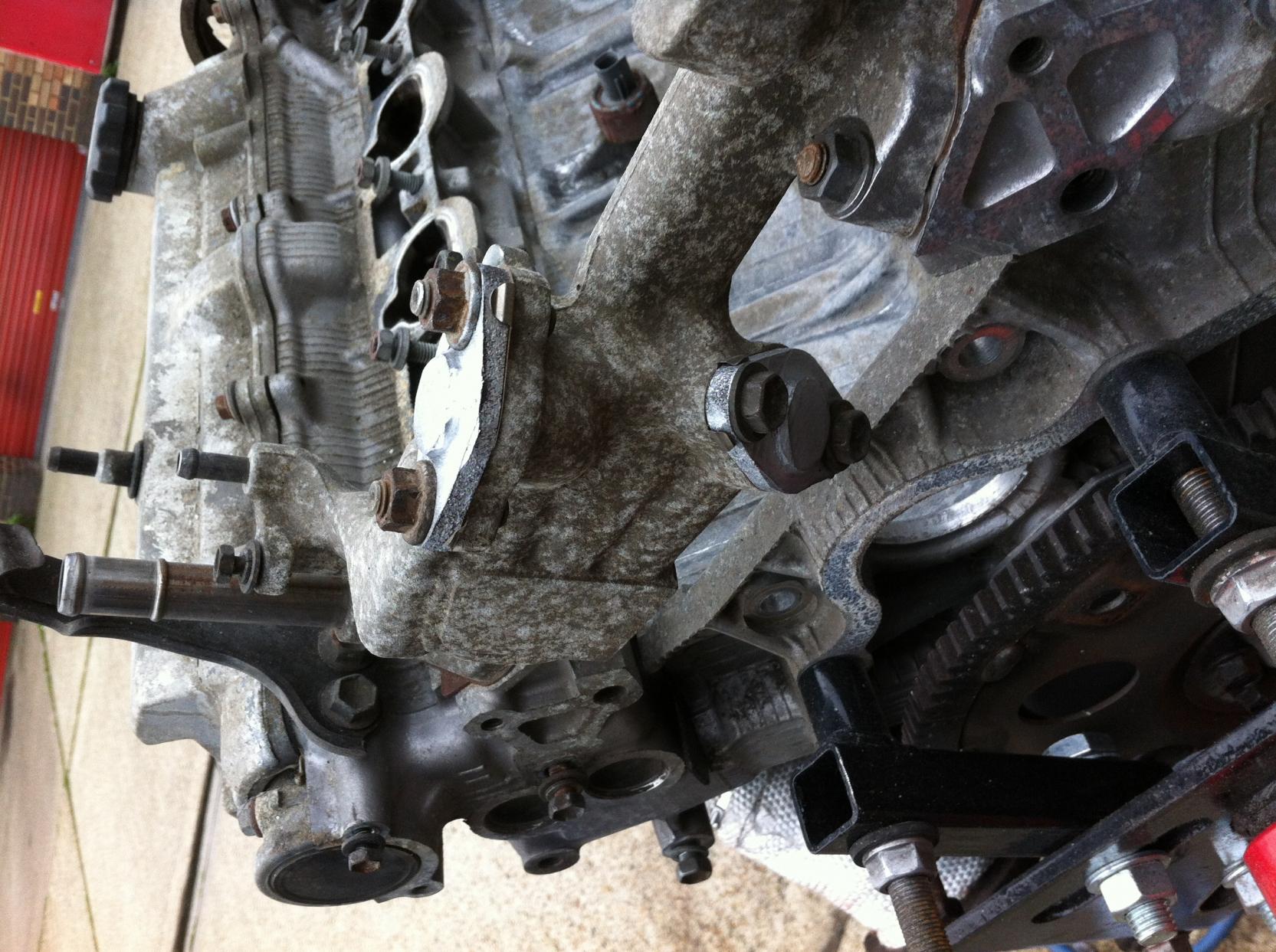

Say hello to my little friend!
  • #46
    More pics
    ALL THE GEAR!............no idea!
    • #47
      Egr blank pics
