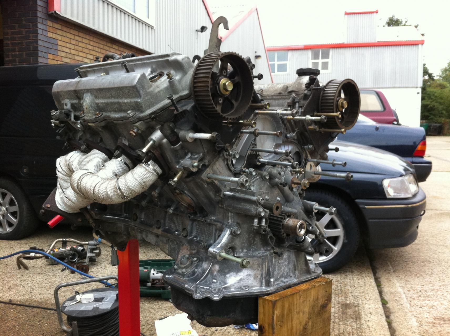

                                So got some more bits done today.
                                Egr valves blanked off
                                T belt removed
                                Exhausts wrapped
                                Bit of cleaning up done
                                Think I managed to get some crap in the bores though dam it!
                                Was gonna do heads anyway
                                Do I need to replace head bolts?
                                Does anyone know where to get a top end gasket set?
                                Thanks Vince :-)
