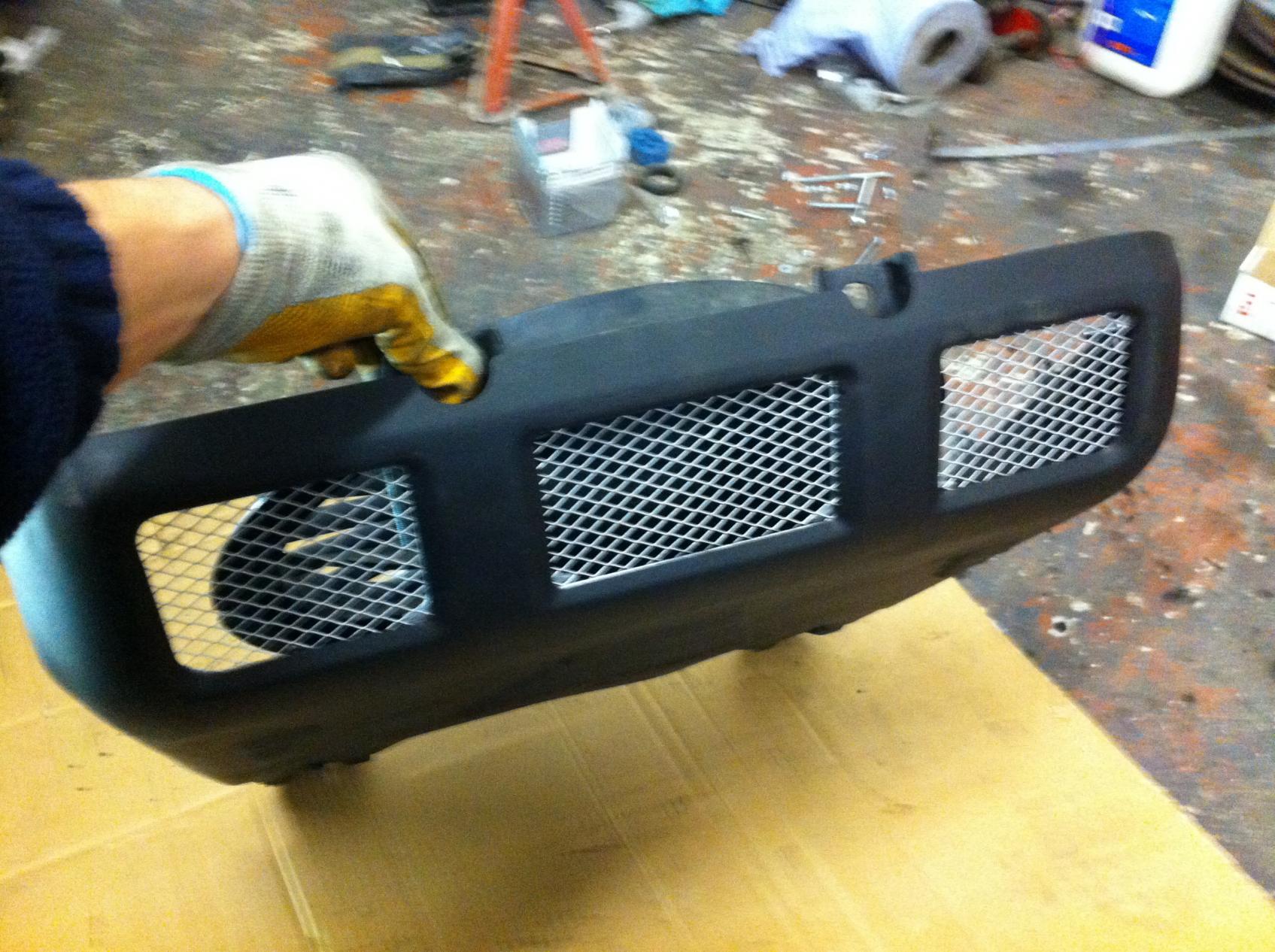

Sand blasted and Painted
Say hello to my little friend!

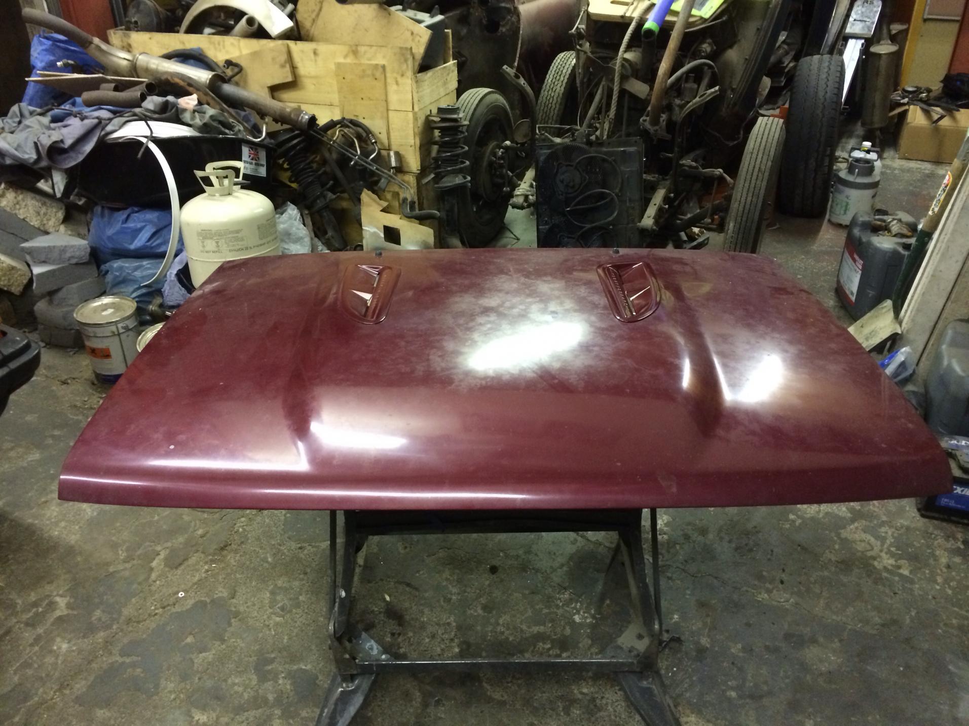

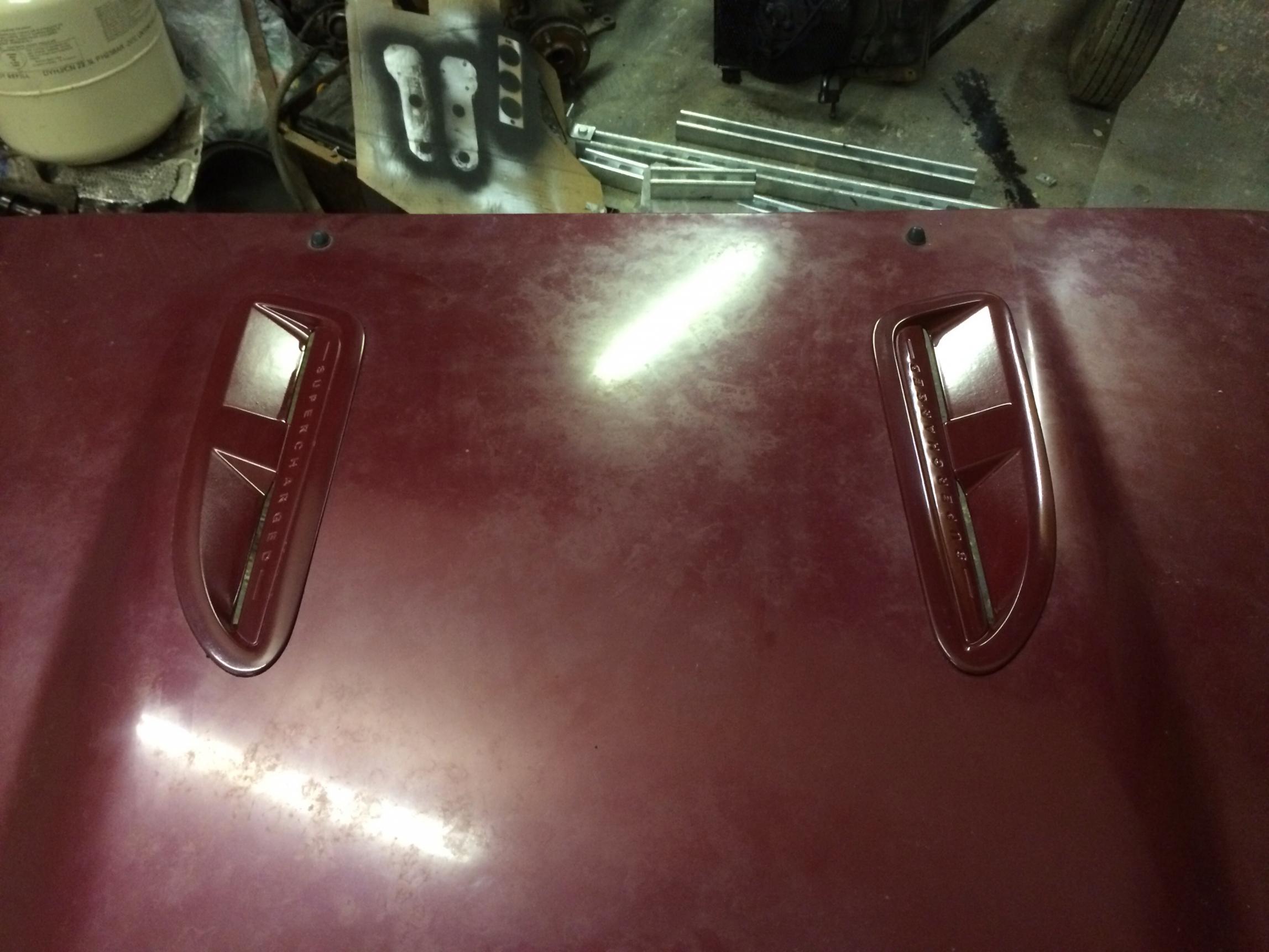

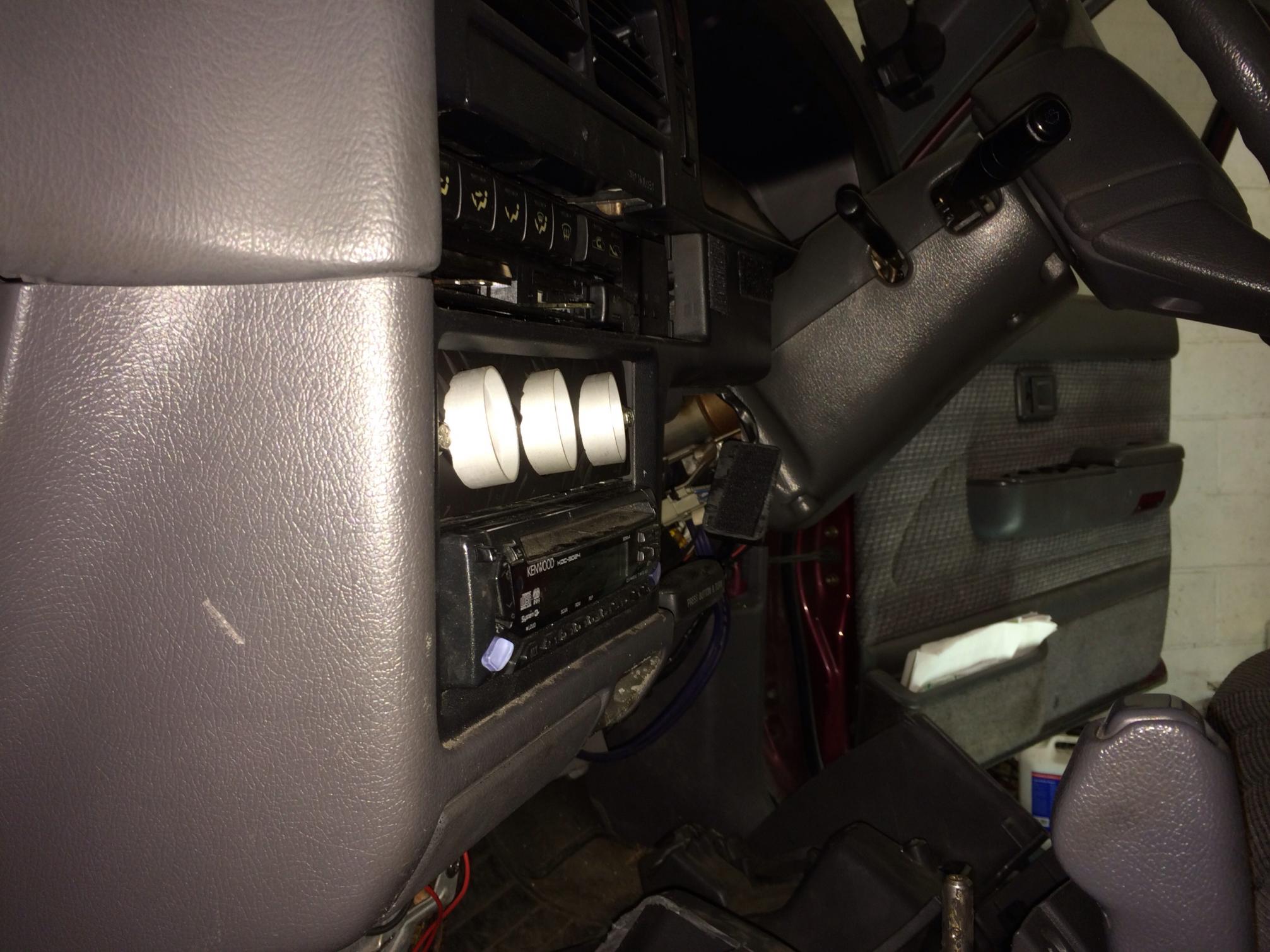

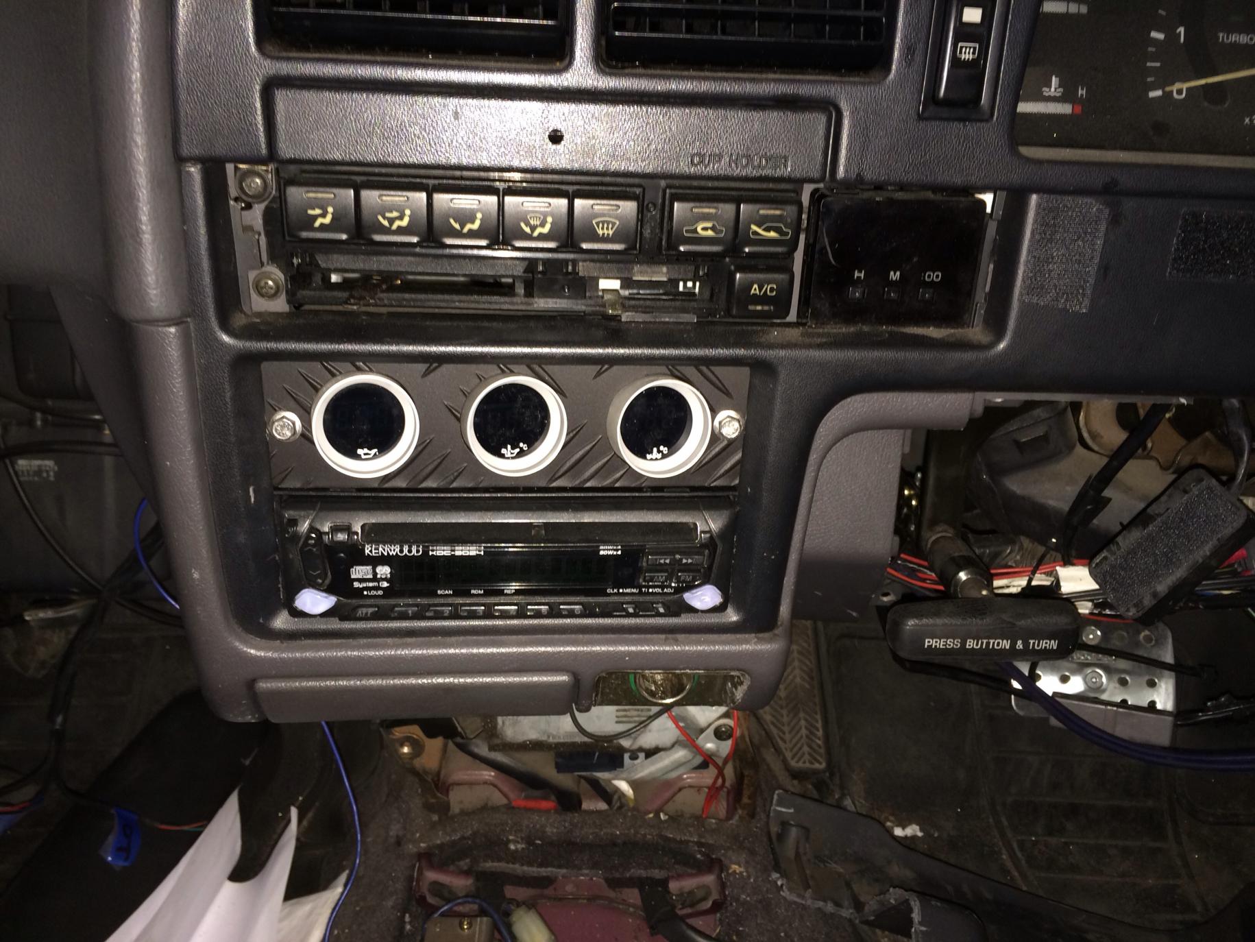

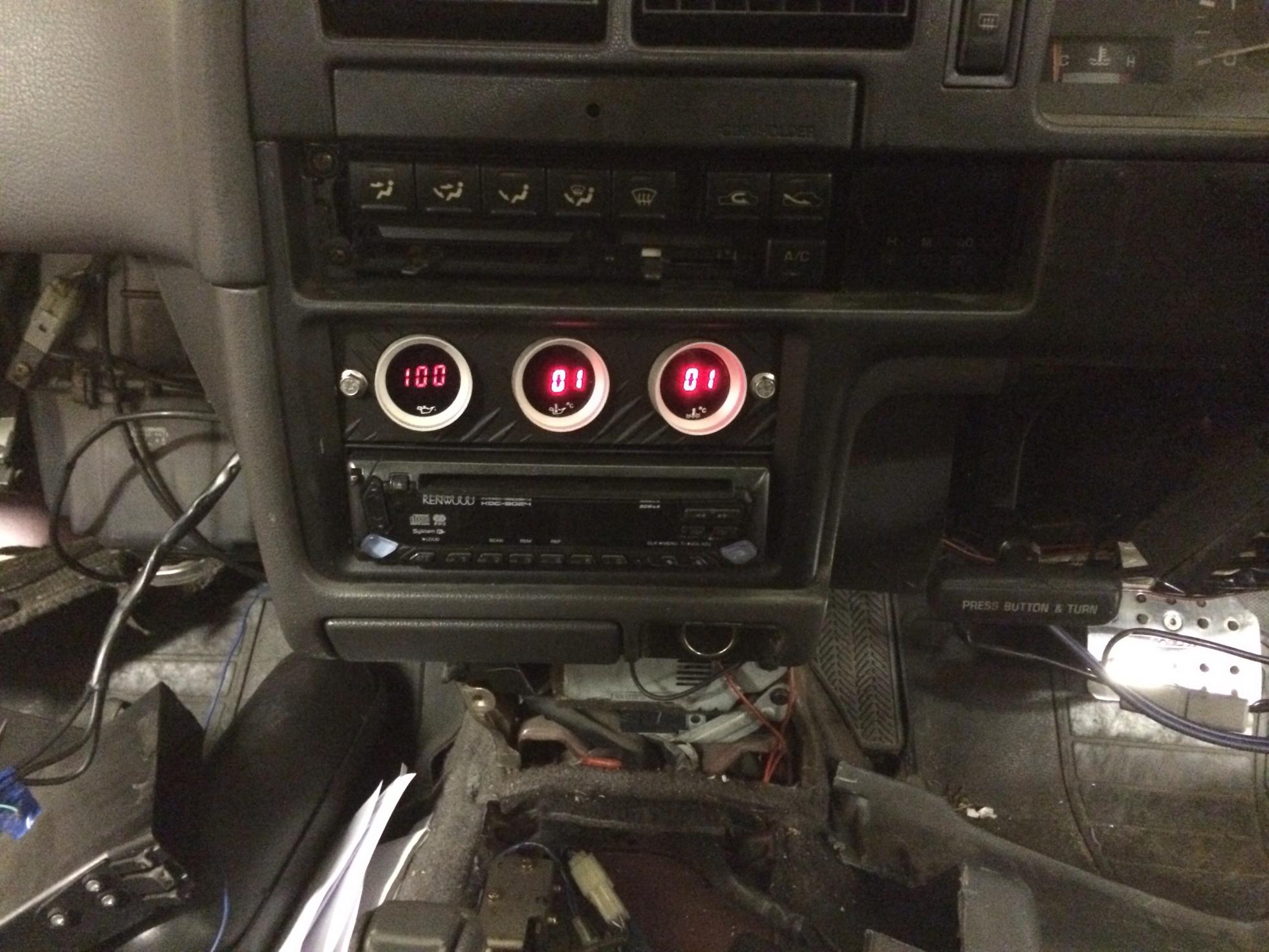

Few more bits done this afternoon/tonight, fitted gauges above stereo, fixed towing plug bracket, bled the brakes, fitted bonnet vents.

Few pics of the dialsALL THE GEAR!............no idea!
