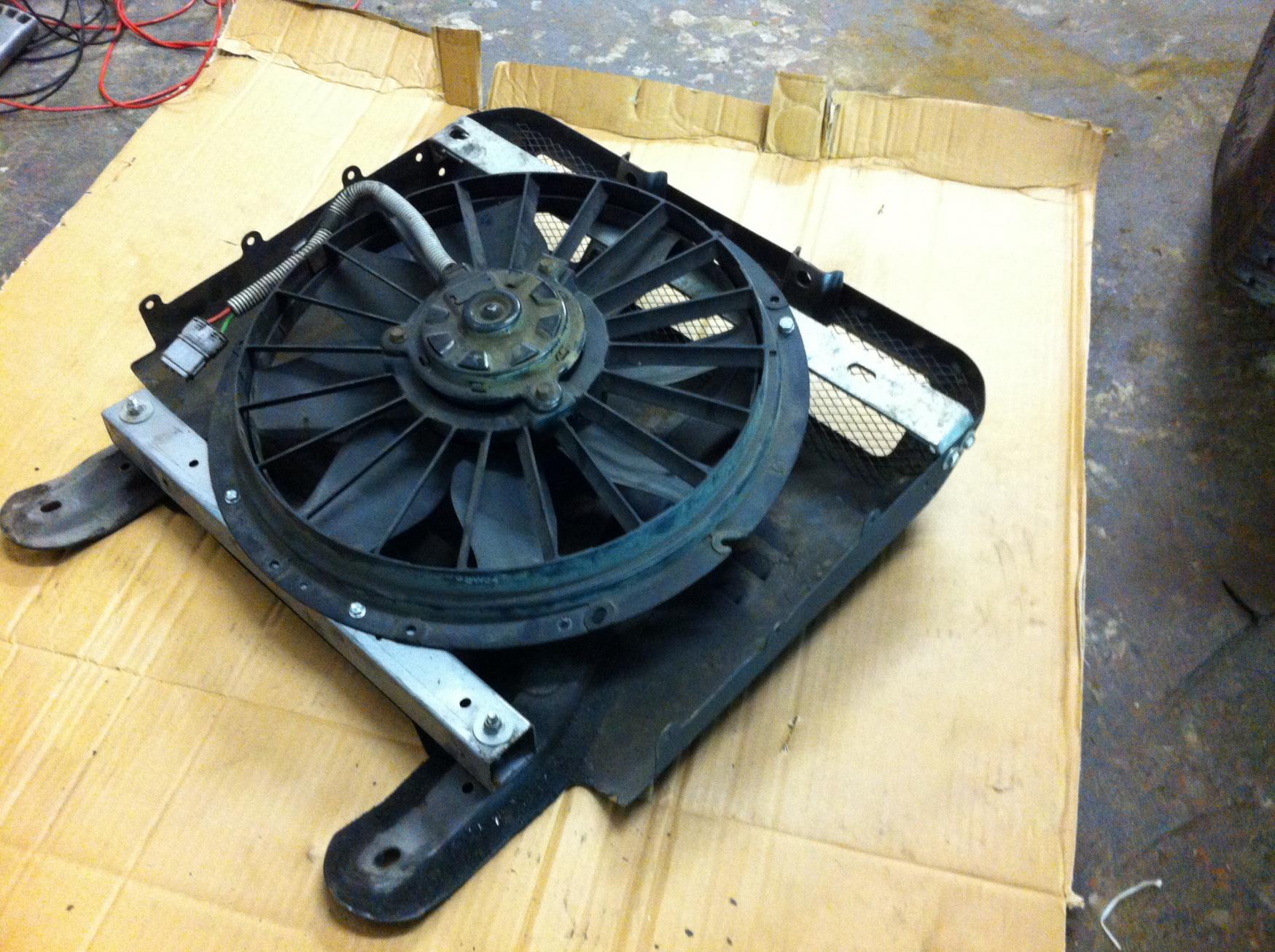

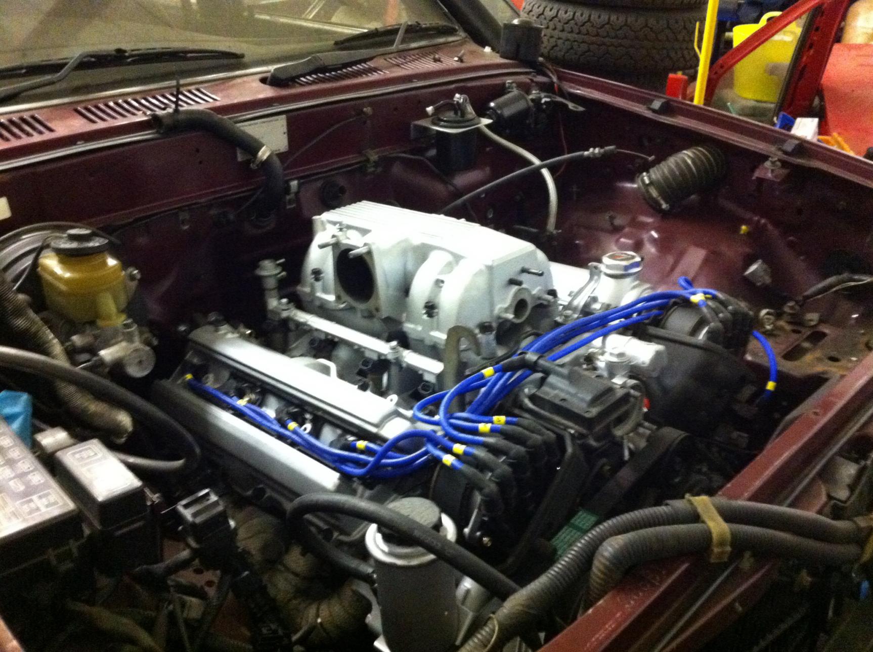

    Been a busy few days, the engine is in and all bolted together, the tank is in, the prop shafts are in, the exhausts are done, gear selector needed extending by 25mm so that's done, got wires to the fuel pump ready, got the oil temp and pressure sensors tapped into the soarer oil filter housing, got the water temp sensor tapped in. Had an issue with the gearbox as when I bolted it together a weld on the flywheel lined up exactly with one of the threaded plates on the torque converter and locked it up so had to slide the box back off to find this problem, what are the odds! Made a filter holder out of the lexus bumper and installed the fuel lines to the filter, brakes are done. The vlovo fan I got off eBay for £7 turned out to b a sucker so I couldn't use it on the rad so I mounted it on the removeable tray underneath so it sucks up cold air from underneath no photos yet as it's still wet. So nearly there but unable to continue as I have no loom:-(
    Here's a few photos on where I am.

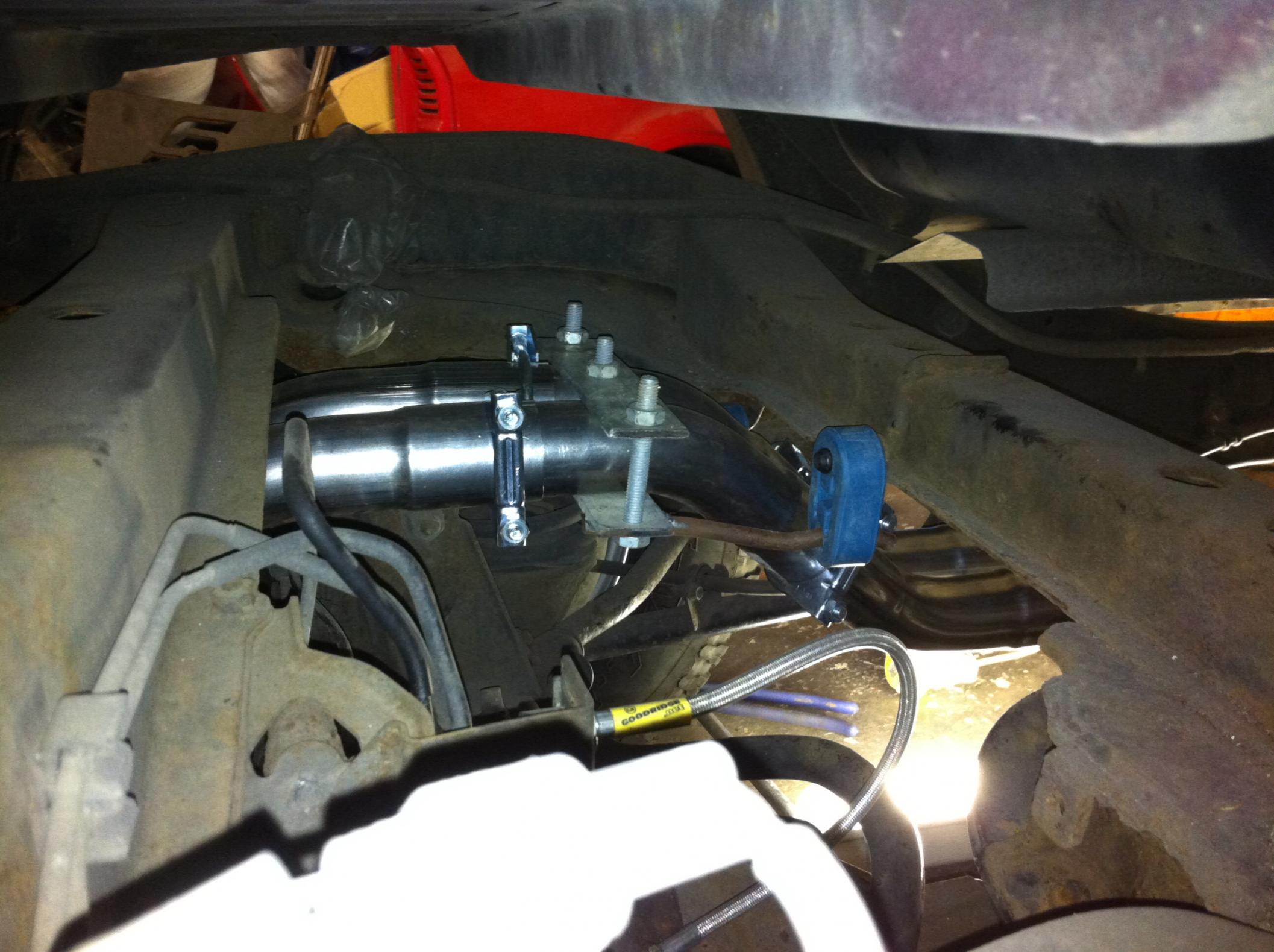

    • More pics of the zorst
      ALL THE GEAR!............no idea!
      • More zorst, the brackets are a bit slap dash but I wanted them to be adjustable but they work.

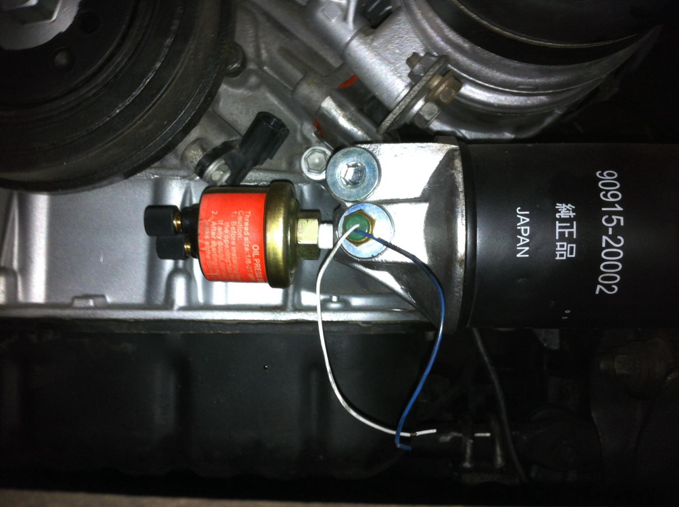

        • Oil pressure and temp senders, these have a tapered thread so I had them all machined, having an engineer working next door is a touch, got all three sensors done with only having to hold a ladder for payment! Happy days

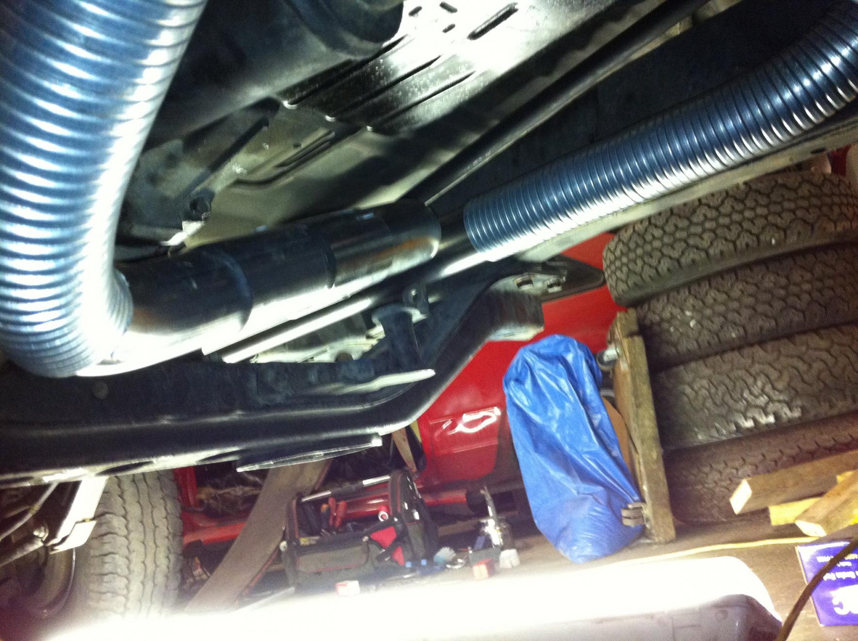

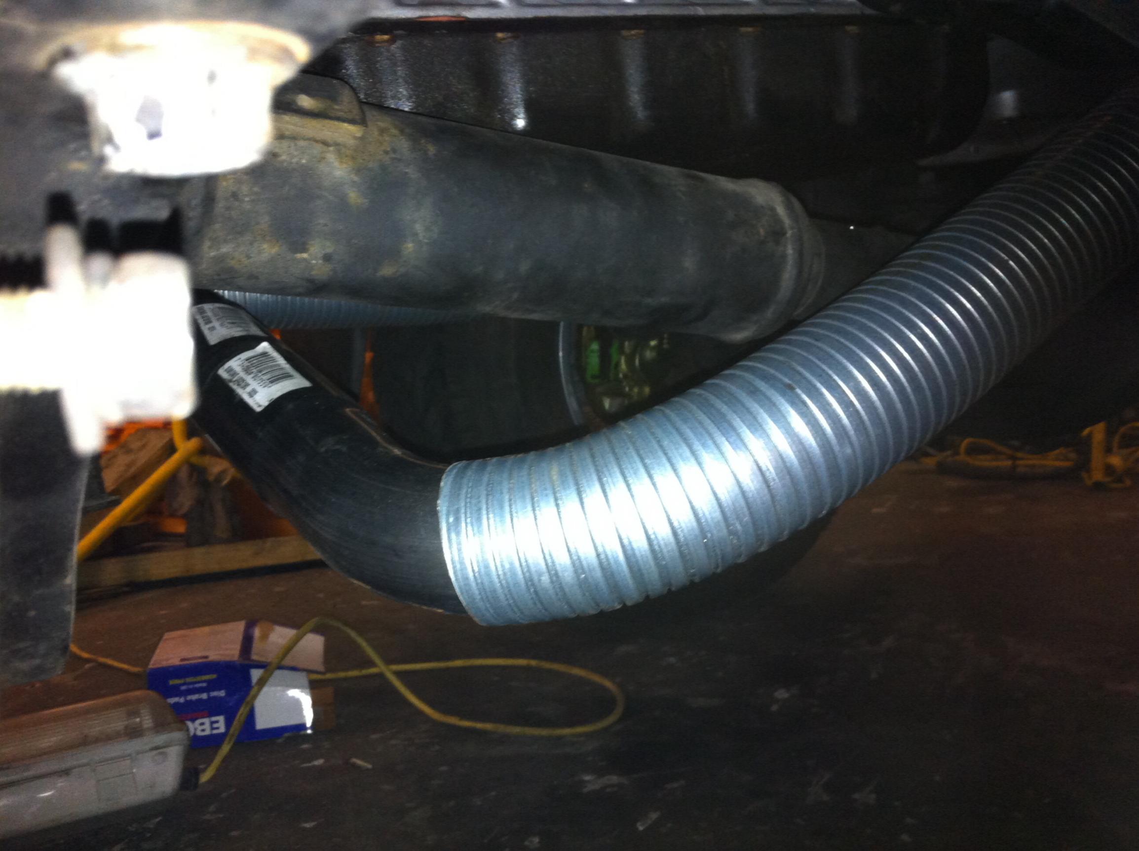

          • Flexi exhaust going round front prop
            • Exhaust over axle

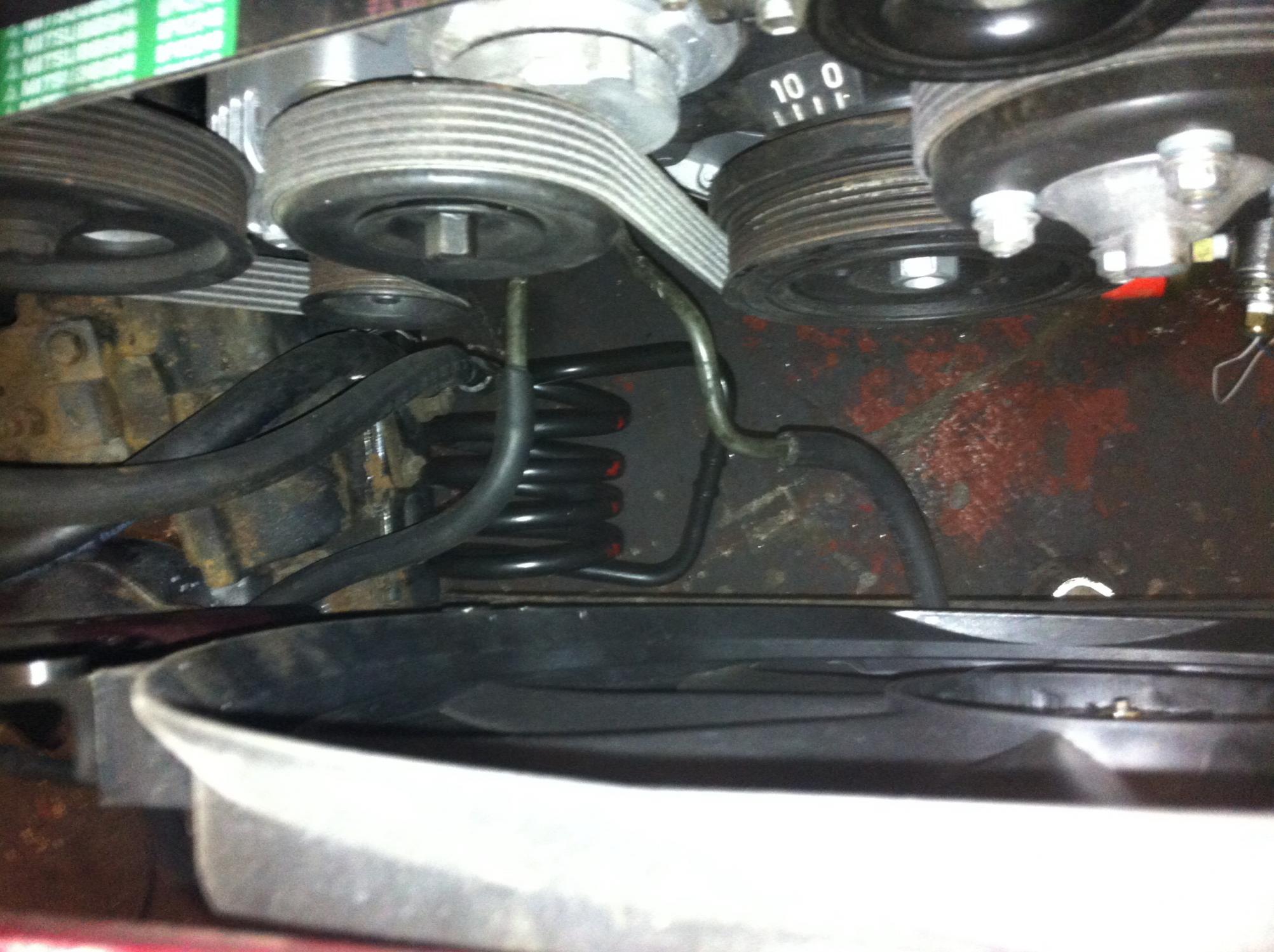

              • Power steering cooler which I got off eBay for £8 from an Alfa as I sold the lexus one

                              • Sucker fan mounted to tray
