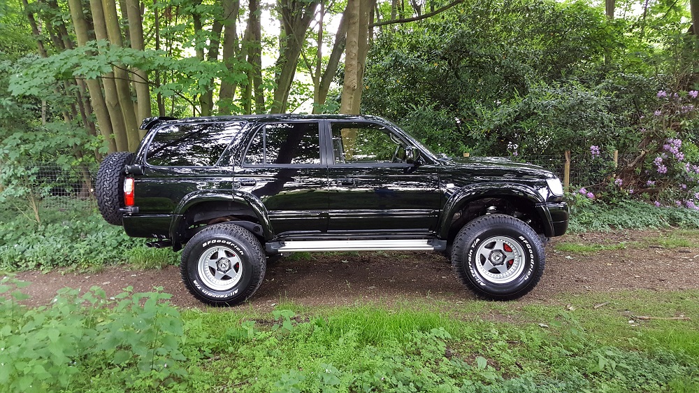

        As my other half's brother's neighbour decided to blast out the fuel tank in his kit car, covering the side of my truck with some form of watery, petrol mis with some horrible fuel additive, I decided tog et it properly machine polished, (regular polishing wouldn't move it) one done it was also sealed with the Williams ceramic sealant, it also had a full inside valet with protection applied to that too.
        All in all it looks like a top job, I can confidently say it has never looked so great!
