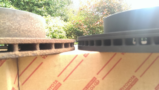

Latest change was fitting Tundra V8 disks and callipers...
Unfortunately one of the bleed nipples was smashed off when they arrived from the states.. I got it repaired, rebuilt, fitted, tried to bleed and got a mist of brake fluidA replacement is on its way...
I rebuilt the calipers with Toyota OEM parts, replaced the pins, anti squeal shims etc, parts below:

Front Disk x 2 43512-0C011
So, Pics!!
Tundra Disks Vs OEM. Mine were warped to buggery... a common problem apparently...
Lots of meat for stoppage! I *really* need these!
