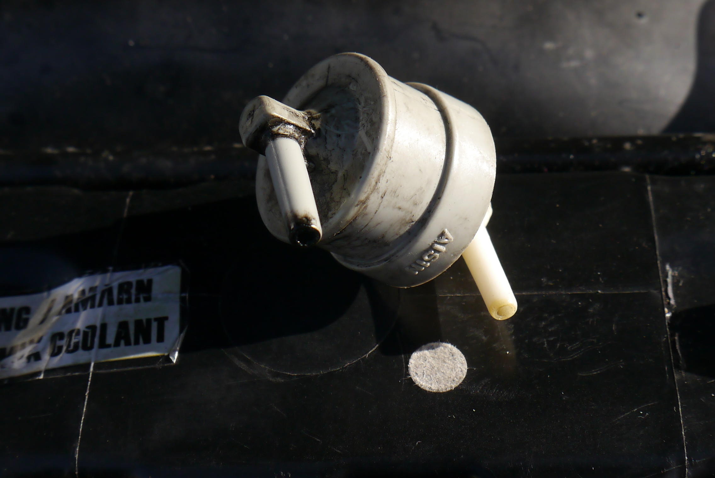

            How's about this filter looking thing from by the turbo sensor? Worth a clean to help boost flow?

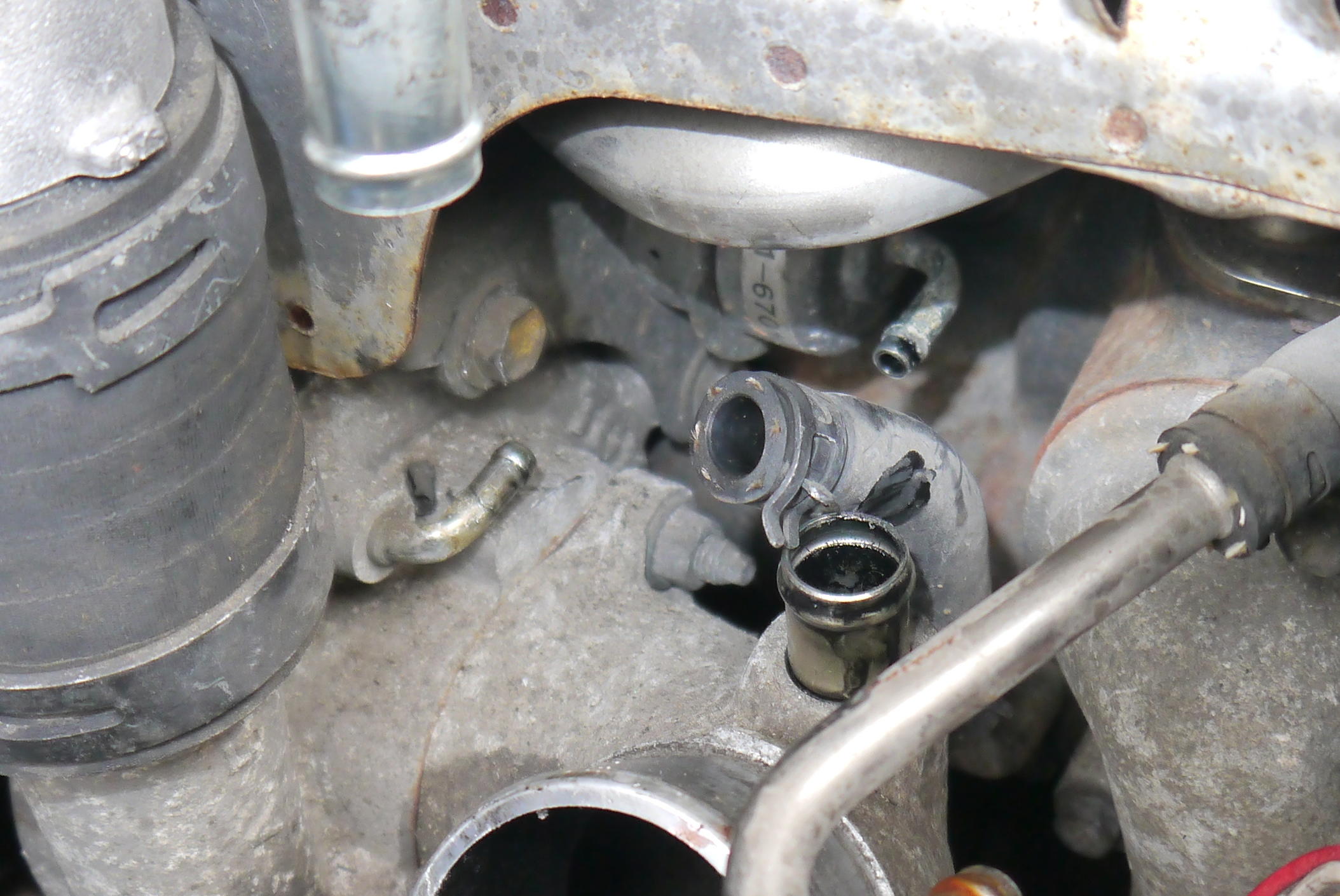

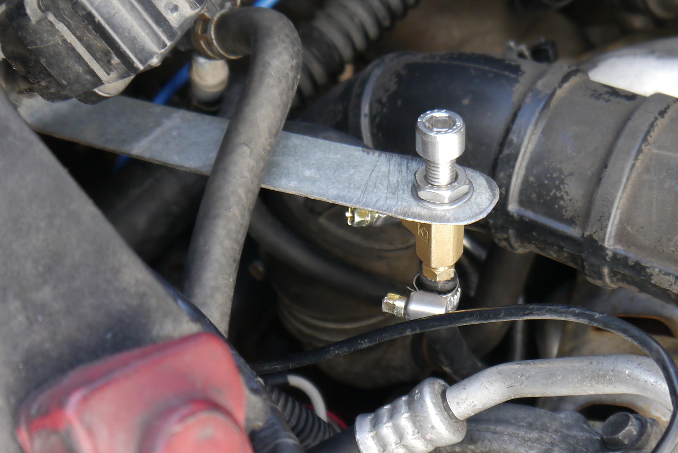

              here are a couple of pics of the boost controler instalation. Appologies for the lack of microsoft paint skills.
              First picture shows the smaller turbo pipes and the others are the water and oil pipe removed to allow access.
              Second picture shows a simple bracket I quickly made to hold the controler.
              second picture needs rotating 90 degrees but I'm new to windows 10 and I'd rather be outside than learning that cr@p! I did try though
