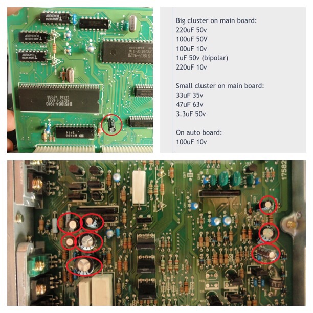

                          Thank you all so much for your replies. After doing a bit of research I've decided to have the electroylic capacitors changed in my ECU. Apparently the general rule is that most capacitors have an average lifespan of around 10 years so as my ecu looks like the original one it's done pretty good. I've managed to buy them all from Maplins, total cost £5.69 and and I've found a very competent electronics engineer to reinstall all 9 capacitors at a cost of £30. Fingers crossed this is my fix and I'll keep you posted. I've attached a photo to show all the caps being replaced in my Ecu. Thanks again for all your help
                            Interested to hear if this sorts your problem out

                              Yeah, think I'll do the oil change after I've put the Ecu back in. Fella recons it'll be done tomorrow so I'll let you know
