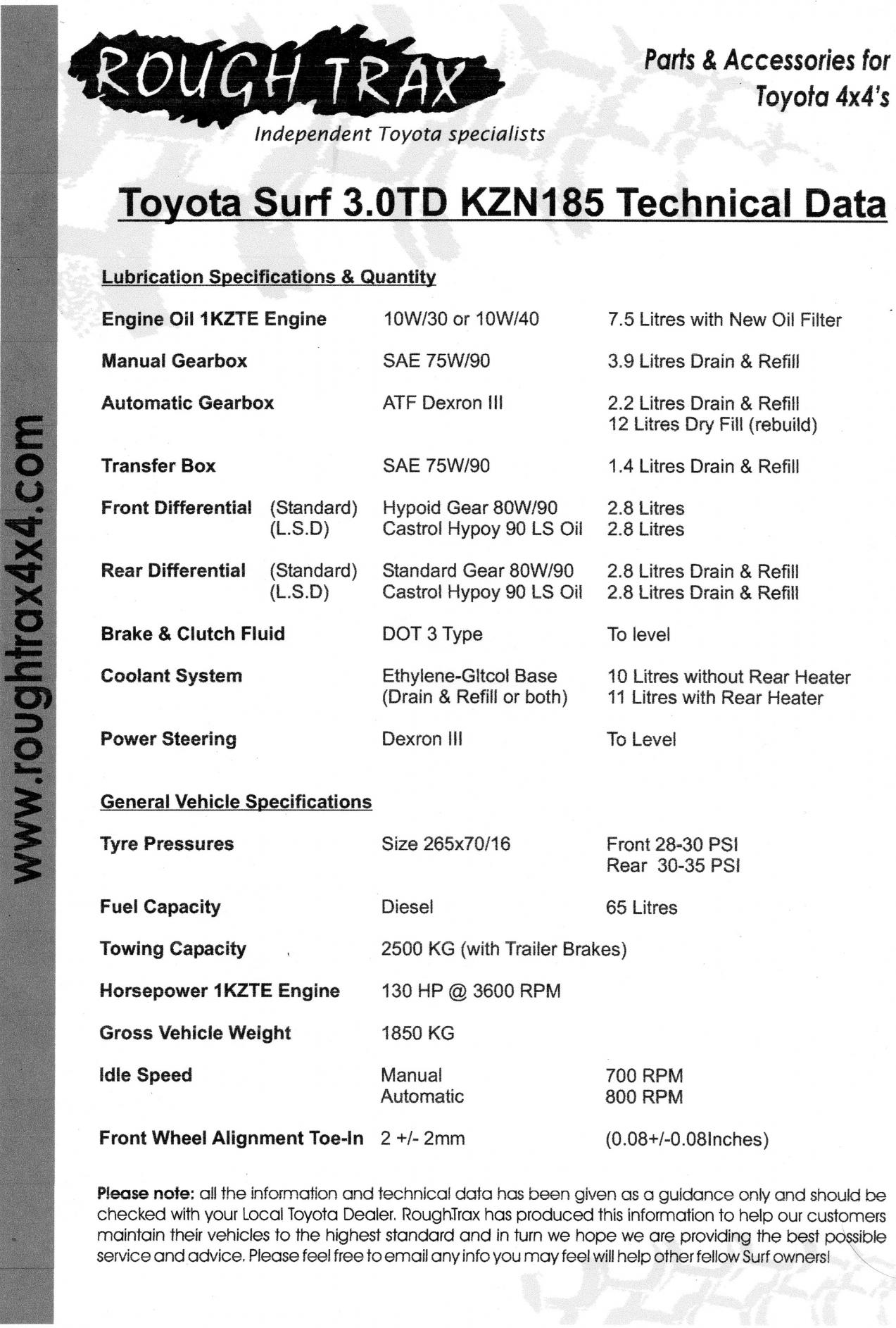

    Looks like changing the ATF fluid its a mucky brown in colour,
    been sifting through some of the threads on here but i'm a bit confused,
    I've read that to do a complete change its the 2 bucket method .
    but the 3 threads that I've read say that it didn't pull the new oil through
    and that it takes about 35 litres for a full change .
    I printed off Technical data sheet off ROUGH TRAX for Kzn 185 and
    on there it tells you 12 litres from dry . 2.2 litres drain & refill !!!!!!!
    data sheet attached from rough trax

    When I drained mine I got just shy of the 5 litre container in to refill it.
    If you drain the ATF at oil change, eventually most of the oil will get changed.
    Then do a drain and refill every year.
    I think someone else on here posted this method as well.
      if the atf was ok I could just do a drain and fill .
      but it smells burnt and is brown , so I m thinking it
      must all have to come out to put new in .
      May all 4 wheels keep on turning
        Could drain and refill it every 2 weeks. 20 litres of oil, and slowly take the old out with the new. not much dearer than the 2 bucket method and 35 litres of oil.

            Im with the rest. If you are starting with the correct ATF level you will get approx 4.5l out of the KZN 185 just by draining. Do that today. Do it again in a week or so and then again. till it looks decent. A couple or 3 times should do it using 15-20l of ATF at most.
            I do what Sparkie 67 does and drop out the pan contents and refill at every engine oil change. Mine always looks nice a reddish.
            Tip, I assume you will remove the bash plate to do the draining. Leave it off until youre 3rd or whatever drain and fill as bash plate removal refit is the hardest ( most labour intensive) part of an easy job
