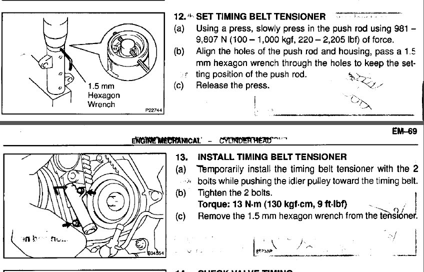

    • #17
      Make sure you remove the tensioner and press it back in using a vice. Use a small allen key through the hole to hold it in.
      Then fit the belt and push the tensioner pulley against it before re-installing tensioner.
