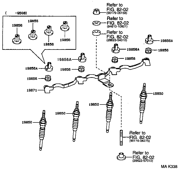

          check how you have refitted the glow plug rail, if the insulators are wrong it wont go, and that the relay is working
            Can you expand a little on this. There is power to the glow plugs. Relay???
              Should be fitted like this
              This is from the bottom to the top
              Blue spacer (raised centre/post)
              Wiring connections
              Black spacer
              Washer
              Nut.
              Would also check the 80a fuse for the glow plugs

                  80 amp fuse is fine (broke the old one trying to get it out). Alot of the spacers are missing/lost but have insulated where needed to stop rail etc... touching where they shouldn't, will this do or do you think I need to get new spacers?
                    Sorry to keep on about this but I'm at a loss and desparate.
                    idealy new ones, remember this is a big ish loaded circuit with all the work that has been done do you want to spoil the job for a few quid?? What price peace of mind and reliabillity. You realy do not want loads of amps shorting out
