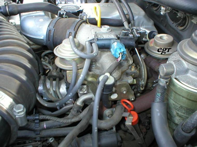

                              heres the egr

                                EGR stands for Exhaust Gas Recirculation and doesn't have any fuses. It is a vacuum activated unit which under certain engine conditions recirculates exhaust gas into the combustion cycle. The reason for this is that the inert gas in the Exhaust lowers the combustion efficiency and reduces the temperature of burn to below the temp that Nitrogen Oxides are formed. It is purely a emission control function.
                                If you do a search for EGR on here you will find a number of posts and some pictures showing where it is.
