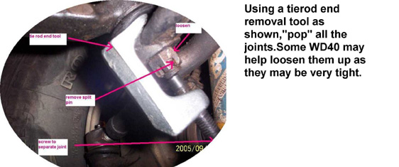

i was determined that i would do them using the hammer but after trying both sides for some time i gave up and went for the easy and quickest option in the end and then was wondering why i never just went out and bought one to start off with
How to look like a prat in three easy steps.
1) Spend several hours trying to hammer out a track rod end.
2) Phone a mechanic and ask if you can borrow their joint splitter, to which they answer: Give the housing that the track rod taper goes through a good whack or
two on the side and then whack the thread end of the rod. If that don't work, come
and pick up the joint splitter.
3) Give the housing two good whacks and one on the thread end and see it pop
out.
I've got a right arm like Popeye from all the bashing I did earlier. Tried his method,
three whacks and out it pops. Ever get the feeling...........?
Just got to separate it
from the tube now.

As you can see above, the hammer worked.Originally posted by stormforce1067Yea
Wouldn't be so bad, but the only
reason I tried the method he mentioned is so I wouldn't feel guilty lying about
trying his method and it not working when I went to pick up the joint splitter.
Bugger.
I'll definitely be picking up a joint splitter next week though. I know
full well I won't be lucky enough for that method to work again next time.
