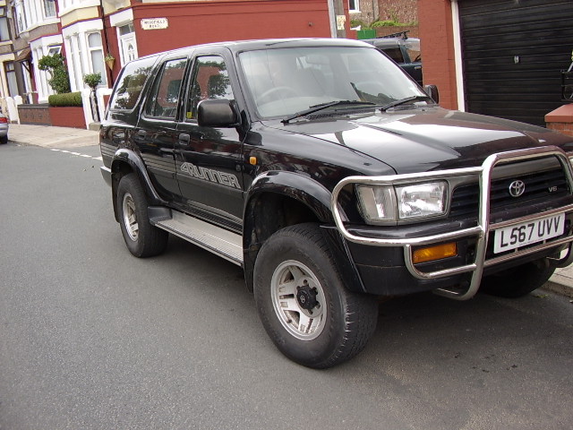

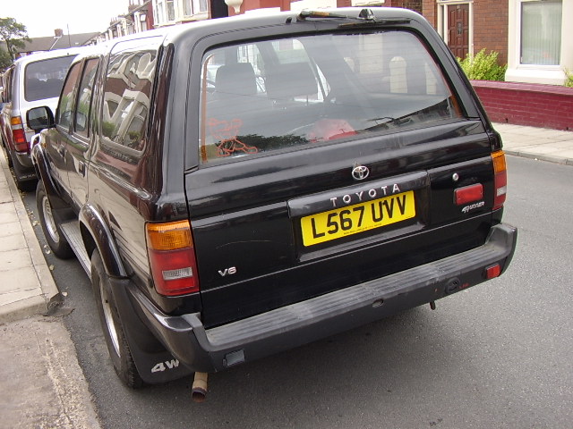

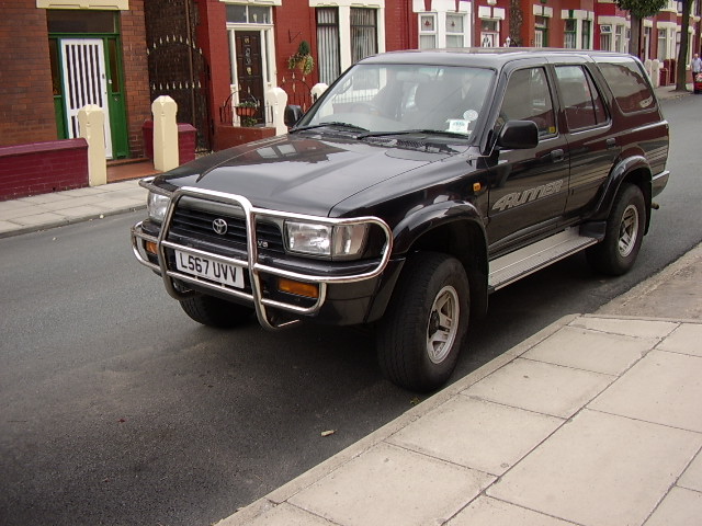

        Hi l have a nice cheap 3litre V6 1994 4Runner with gas on if your interested taxed and tested.

          hi bob
          would this be manual or auto?

            Hi it is a manual gearbox.

              hi bob
              thanks for the offer, if it had been auto l might have been tempted, but l am trying to get away from a manual. have we definatley decided that this auto box wont fit on the back of my hilux engine, if so whats not right is it the bolt
              patten for the flywheel/starter ring or the shape of the bell houseing/engine block. is there an early version of a surf diesel thats not ecu controled, might an auto box of one fit my hilux. l only ask because there is a surf on ebay item no 320009026008 thats described as a 2lt diesel with auto box, or is this just a misprint and its a 2.5 lt.assuming l cant use the auto box ( which sounds likely ) my next choice would be to used my lexus engine/box, but as l would not want to take my hilux off the road for 6 months l think l should go and buy a rolling chassis have it blasted, powder coated etc fit engine/box etc and then fit my hilux body ( or buy another ). do you break surfs would you have a rolling chassis?
              thanks andy
