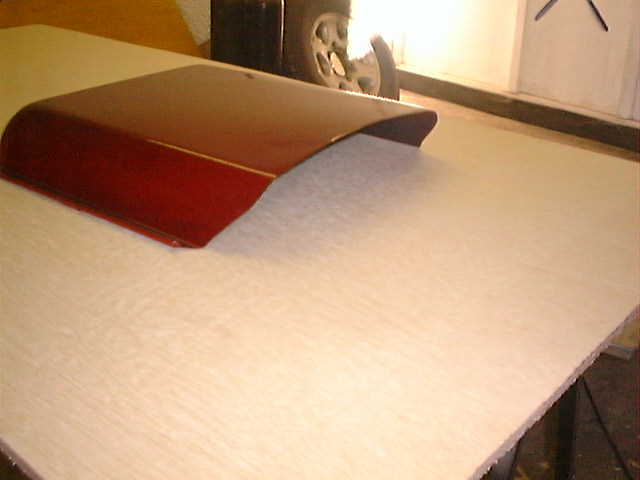

Easy guys have a look at my install. its a top mount RX7 intercooler. not so difficult to fit but have to do some modifications to make it fit.The vent is a modified WRX unit.Look at the pics:
Mm i dont know on which impreza it came out on but you can find those on sale on ebay.Mine has been modified to let more air comming in.it was cut and not has a bigger intake.
What about a turkey roasting tin with one side cut out? You may think I am jesting but I wouldn't have known that is what the scoop is on my mates car. A bit of a rub down with course wire wool, slap on the plastic padding, rub down and paint.
